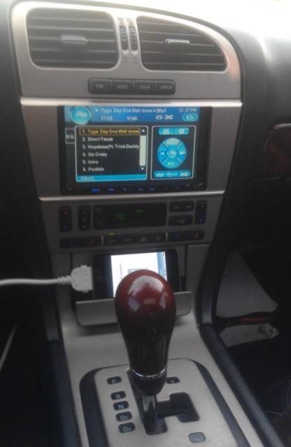

it was a cheap stereo but worked I had to splice the wires since the previous owner hacked it up and I don't think the double din dash kits work with 7 inch receivers because ive had to cut them with a dremel
