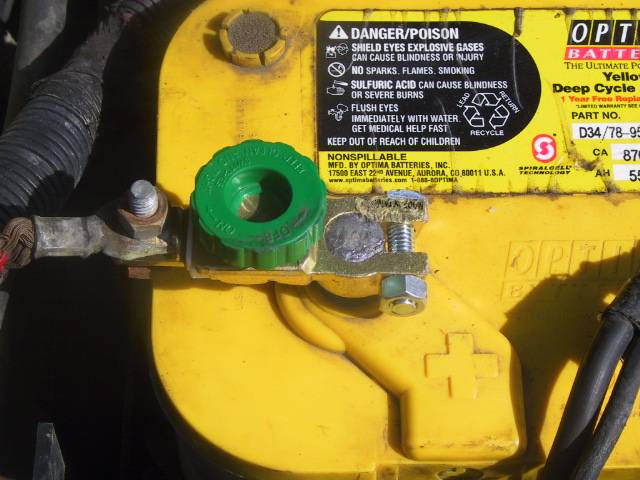

Im pretty bad about not charging it when it runs down, so ill be running one of these from now on.

i agree with the optima. running a yellow top in my cobra with no issues.ive had it for 3 years now.
Go with the yellow top Optima FTW! its the best battery ive ever owned. here in Minnesota where it gets to -35 below, my 93 started every day being parked outside. it never failed me all winter.

The most important thing to remember about wet cell batteries ( and Optima style? ) is that the need to maintain a full charge to keep them alive. and cold weather is the enemy along with poor maintenance. The quick disconnect will eliminate any parasitical draw that exists but you must do some thing to maintain a full charge if your car is sitting in the cold for a period of time. That's where trickle chargers come into use. There are some very efficient ones out there including solar powered chargers. I don't think the brand name of the battery is as important as getting one that has a good cranking and storage capacity. Don't buy the cheapie. Go for one that is good for 4 or more years. If you are running a high powered sound system, then there are other issues and solutions that I'm sure you already know need to be addressed.

where can i get one of those terminal disconnects? I tried searching oreilly's and autozone, but they dont seem to have it.
