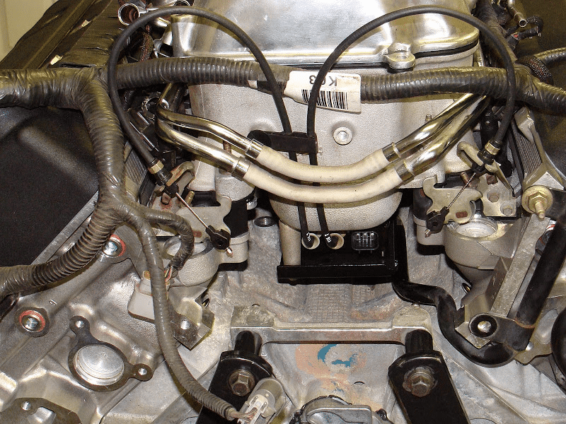

I have the same issue with IMRC being closed. I think it's the driver side? Hard to tell. I've followed the cable to what I *think* is the passenger IMRC lever and it moves just fine though I'm not sure if it's the right part or not.. drivers side I can't reach at all... Difficult to tell what I'm moving around back there. Should it be moving up and down or front to back?

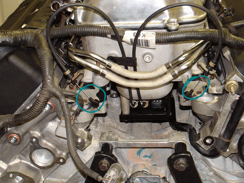

Where are they ? :oops:
Thanks.. This is what I've been pulling on (bottom to top) on the passenger side. Looks like it may be easier to snake my hand from passenger side to move the driver side.
