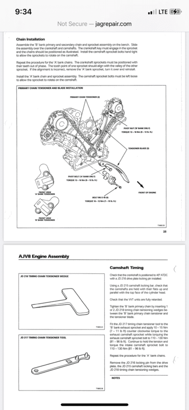

Thank you ajv8 for the wealth of knowledge with this book , but i do have question about the v6 and v8 camshaft install and timing. Are they both the same or is there a diffrence in how they are completed from v6 to v8? Again thank you for the booklet it has proven to be good reading and knowledge.
In the booklet ajv8 sent me it only shows the v6 not the v8 assembly. Im feeling kinda stupid here im reading other post and they make it look so easy. I have to say i do envy anybody who owns a LS Lincoln. These cars are a labor of love. I do love mine and so bad would love to keep it but the time and money to keep them running is like a new found wife.

the v8 is the first section until page 90 or so
