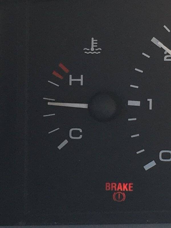

            I see thanks for that info .. but if my car is all stock (except my radiator is aluminum by company called griffin) then I would only be able to run 195 rite ? Without doing a tune for 180 degrees
          • popstar
            popstar LVC Member
            Messages:
            11
            Likes Received:
            6
            Joined:
            Sep 3, 2020
            Location:
            Phoenix, AZ
            Yes you shouldn’t have a problem. If you live somewhere where it gets very cold then 195 should be ok. But for the south and southwest (I’m in Phoenix) most people run 170 or 180 or lower to keep intake air temps down. These engines run hot so anything you can do to make them run slightly cooler is generally recommended. I would imagine with that nice griffin radiator you won’t have any problems whatsoever.

              I see , this is my first summer with my LSC I had got the car in the winter of 2019 so I didn’t get to see how the car reacts in hot temps ... but lately and all last week it was 95-101 degrees outside ...so the needle goes this high let me show you a picture but it scares me and doesn’t seem normal because it if I leave the A.c weather in “Max AC” setting or “automatic” setting the needle will rise higher unless I turn off the AC and then The needle will drop slowly back to the middle of the gauge ... and wondering if I do put in 180 I don’t have to have the computer adjusted for the fans to come on sooner or something like that I rmbr reading about ? Also the needle only goes up while driving with the AC on if I’m sitting at idle the needle stays dead in the middle ! I appreciate all the knowledge by the way brotha !
            • popstar
              popstar LVC Member
              Messages:
              11
              Likes Received:
              6
              Joined:
              Sep 3, 2020
              Location:
              Phoenix, AZ
              That’s barely one or needle marks past the middle, mines like that or slightly higher all the time in AZ summer. I wouldn’t worry about.
              I don’t know why it goes back to middle with the ac off. Mine usually comes down with the ac on. Off the top of my head I would think it has to do with engine load. Ac does put some load on the engine and these engines are very sensitive: temp goes up during increased load. I personally would not worry about it unless it goes up right under The red area. A tune is helpful but not necessary for a 180 thermostat. It will just take longer to get up to temp but that’s not a problem with these cars where we are since it’s already hot.
              No worries man. Glad I can offer some help.

                Well if I drive about 50 miles on a hot day any mileage after that with the AC on and I see the needle teeter that high like the photo I sent you , & keeping the AC on the needle will begin to go higher to the 3rd mark ! So I turn off the AC and the needle will then come down ... Although next time I’m going to just leave the AC on and see what happens once it starts teetering upwards and I’m going to put a 180 thermostat soon then

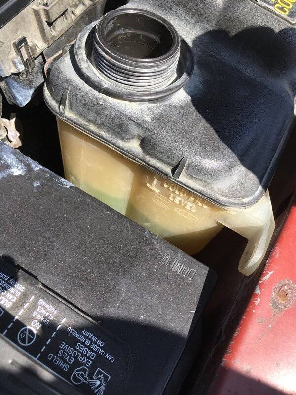

                see I have never had cooling issues with this lincoln up until I had to do the water pump I took it to some shop and they did the water pump , but the a**hole mechanic told me the radiator was full when I asked him is the car ready ? He said yes and I drove off pretty fast From his shop and he didn’t even fill any fluid at the crossover tube, smh, he only filled at the reservoir .. I drove off from his shop thinking everything was fine within 3 minutes needle was almost up at red but didn’t get to actual red but at the white line just before it .... so I hope it didn’t crack the head ... I checked water yesterday morning it was full in my resivor and then I was driving around All over 200 miles I put on the car yesterday and today in the morning I pop the hood and the resivor was low ? Only a waters bottle worth of water to fill it back to the ‘fill line’

                Man I feel your pain! You have to take it to a mechanic who specifically knows how to work on the 4v 4.6. I learned that the hard way too.
                I would redo the full coolant burp procedure yourself from when the engine is cold.. it might take several cycles to get all the air out. There should be a sticky here or on SVTPerformance for it.
                Although unlikely, it could be the water pump: did you get the upgraded motorcraft water pump (pw423) used in the 03-04 cobras and Mach 1s- the one with the extra ring around the vanes to prevent cavitation and push more coolant? Water pump without that extra ring on the vanes are not as efficient. Thats a good ford upgrade and they’re like $35 on rock auto. I found out about it from the mustang forums. I wouldn’t worry about a cracked head. You have to seriously overheat it to crack a head and it will warp before it cracks from what I read. I would try to get all the air out of the system over a few days of checking and adding more (distilled) water then go from there. Most people say if you’re running hotter than you’d, like turn your ac on, it kicks the fan on immediately and generally it brings the temps down. I bet the reason it’s acting funny is from air in the system. Now that I think about it, with your big ass griffin radiator it’s got to be air, cause you’d think it would run cooler than normal with that radiator.

                  When I put an all aluminum radiator in my 97 last year, I had a hell of a time getting the air out of it. After several burpings, I thought I was good and did a short 2 mile test, one mile in and it was red lined. Parked the car on a steep bank nose up and did the burping all over again, If you think you got it,.... do it again. Finally got it done and a factory Ford thermo keeps the gauge just below half in all weather, AC or not has absolutely no effect. Either in town or running 80 mph steady. When my blend door arm broke for the second time, I found there was a good bubble of air at the joint of the heater core pipe above the dryer. Despite that air there the engine temps were perfect. I still filled that pocket out anyway. With a new china blend door arm in place the AC/Heating runs perfectly.

                    Exactly what I’m thinking someone suggested maybe air trapped in heater core but lately the weather hasn’t been so hot so it hasn’t been acting up ! Went 300 miles yesterday all together from Orange County to all over LA and it was fine AC on and off periodically. And with the water pump I got a generic brand from oriellys because the motor craft was a 3 day way part and I literally needed the pump in within the hour the bad one came out ... but it seems to be working fine ... i’m assuming if I did have a major problem the car would be overheating even if the temperature outside wasn’t hot right... and yea that radiator is really wide and holds much more coolent so ur defiantly right about that brotha , more space = more air to get trapped ... I have about 7-8 different threads open on my iPhone now of different explanations how to bleed the system smh I think I almost got it down lol
                  • BigredLsc
                    BigredLsc Active LVC Member
                    Messages:
                    120
                    Likes Received:
                    5
                    Joined:
                    Dec 23, 2019
                    Location:
                    Orange ca
                    Yeah I think you might be right right there but wow only 1 mile and heated that much ? My needle only startS to fluctuate slightly after like 50 to 80 miles of driving and what kind of aluminum radiator did you put in and I have no heat right now AC works ice cold though
