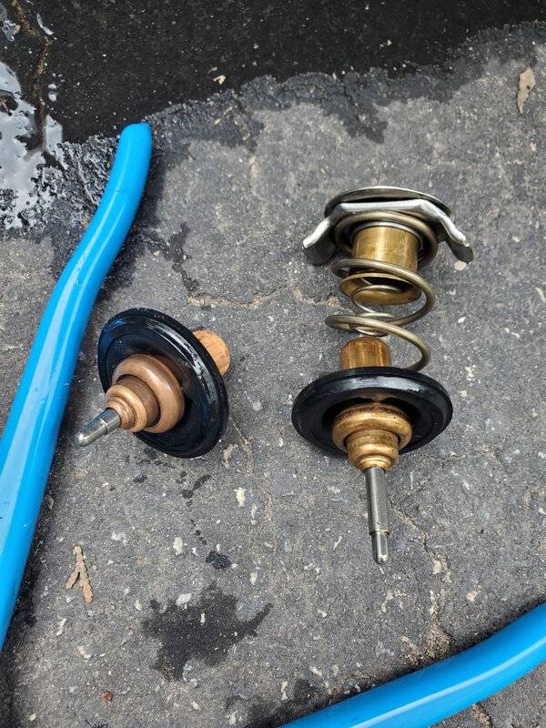

Old thermostat was stuck open. Heats up faster now ofc and am running between 194-199 driving around. Not a hot day.
It took about 20mins to remove but ofc with a mess of coolant. Compressing the new thermostat into the housing is a major pain. It got away only once luckily.

Yeah... that can be a concern. I think it's an issue with the wax in the thermostat... or whatever they use to actuate the plunger. I could see that breaking down over time.

Hopefully you got new O-rings... and didn't reuse the old ones. Tried that once and it didn't work out.

I reused the O-ring lol. There is only 1 if not counting the cap.
