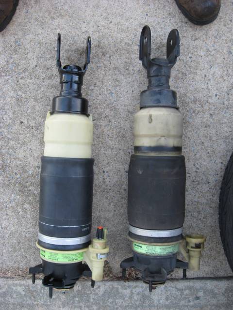

Bad front Air Bag picture here
1969350
Jul 4, 2006
46
Charleston,S.C.

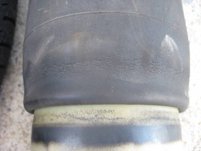

If your front end is leaking down overnight you probably have an air bag that has cracks worn in the rubber that looks like this. Seems rubber even kind of transfers to the plastic strut body as seen in pic next to new one...the new $365 one! Just get on the ground when front is slammed, reach under and squeeze each bag to find which one has leaked down.I figured is was pass side being drivers side looked much newer and was probably replaced with OEM in recent years.
Brakes done. Air strut done. Next whole front suspension rebuild needed.
Don't buy a Mark VIII if you have a T-Bird budget!!!
Hey man, let me know if you want/need any help with that stuff. I've done it 3 times now and also have air tools now (helps a lot!). If I'm available when you wanna do it, I'll be more than happy to help.
