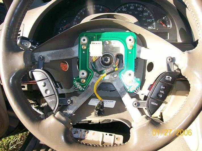

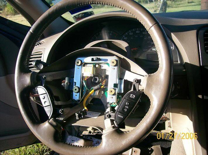

ok, so i started dismantling the steering wheel, i ordered a clockspring from ford a few hours ago, i am stuck here, i have taken 2 pictures of my last 2 steps. The only thing i can think of keeping the steering wheel on is the large black torx bolt in the middle of the wheel. Is this the only thing keeping the wheel on at this point?
Any images prior to this? Mine is out, and I know I can replace it myself... but that whole airbag thing. Not sure what to remove and so on.
no, i didn't take any images before this, but i believe in order to get the airbag off there are two bolts on each side of the steering wheel (right behind your steering wheel controls) underneath those tabs that cover the holes.
