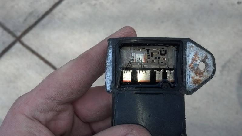

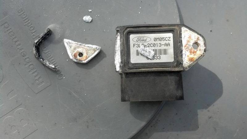

Replaced it and it pumped right up:D:D
Yep, pretty easy job it didn't break until I started to remove the screws, although the case was split when I took it off so I know it was the problem.
I had two replacement relays I tried and the first one I tried kicked the pump on instantly, the air ride switch was off so I unplugged real fast. I'm guessing that that relay is bad?
