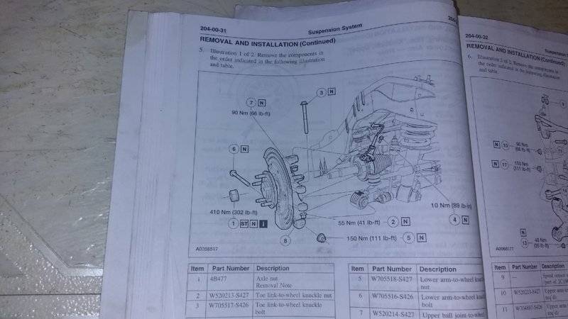

Which one is it?
From: http://deneau.info/ls/s6x~us~en~file=s6x55004.htm~gen~ref.htm
OR
From: http://deneau.info/ls/s6x~us~en~file=s6x42004.htm~gen~ref.htm
I would say 221 lb-ft! spec is 188 to 254 so for sure 221 is correct.

The above was from the 2006 shop manual. The 2002 manual has both values as well.
My 2005 Shop Manual CD shows the same, however, I noticed that the P/N's for the retaining nut in each picture are different. The nut in the half shaft removal and installation section with the 221 lb-ft is 4B423 (Rear axle wheel hub retainer). The nut in the rear suspension exploded view section with the 302 lb-ft (yes, my manual has 302, not 303 lb-ft) is 4B477 (Axle shaft retaining nut). Quite possible that there may be differences in the size of the two different nuts. Another option would be to also look at the Thunderbird and Jaguar shop manuals to see what they show.
