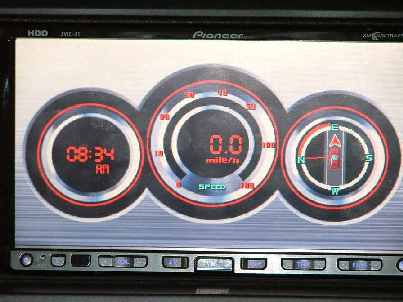

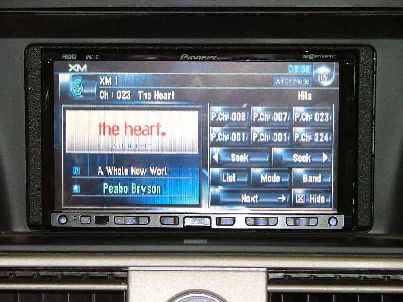

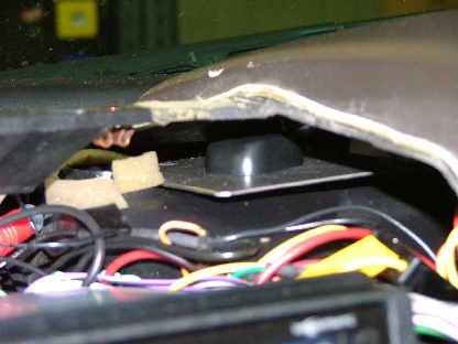

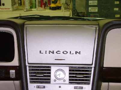

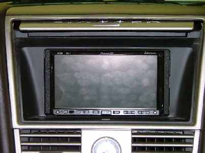

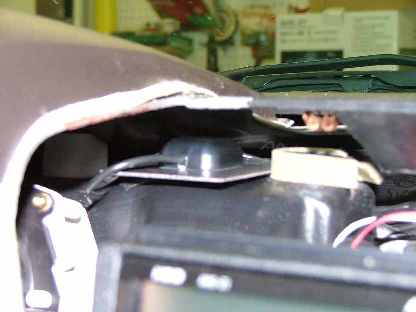

I shot a few photos while I programmed my SWI module... I didn't realize the screen was so dirty! It's a touch screen and it doesn't look like that in person.
The first photo shows the lid closing as normal. The second shows how the unit fits like a glove. The next two are of a couple of screen shots...XM radio and the vehicle dynamics...which you can choose from. The next two are of the GPS and XM antennas mounted under the dash and on top of the defroster ducting. I cut me a couple of pieces of sheet metal and Velcro'd them to the ducting. They won't move and the Velcro will help insulate the antennas from the heat of the defroster. (Like we need defrosters in Phoenix) But regardless, heat shouldn't be a problem. I can only imagine how hot the surface of a car would get sitting in the sun all day and attaching the antenna to that. Anyway, the antennas are magnetic and stick to the plates. The signal for XM is full strength and the GPS connects to all satellites. There is no degraded performance from mounting them here.
