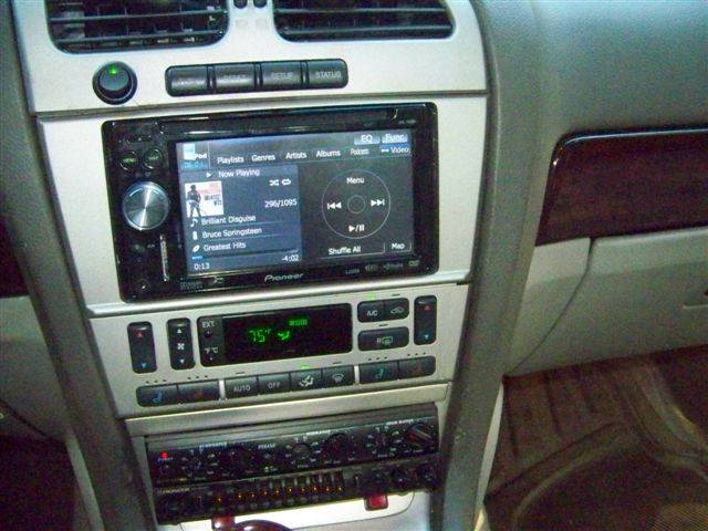

I cut down a factory nav plate and used the side pieces from the kit.
The side pieces are all you need and hold the unit firmly in the factory cradle.

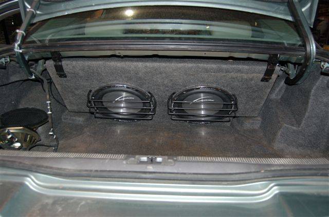

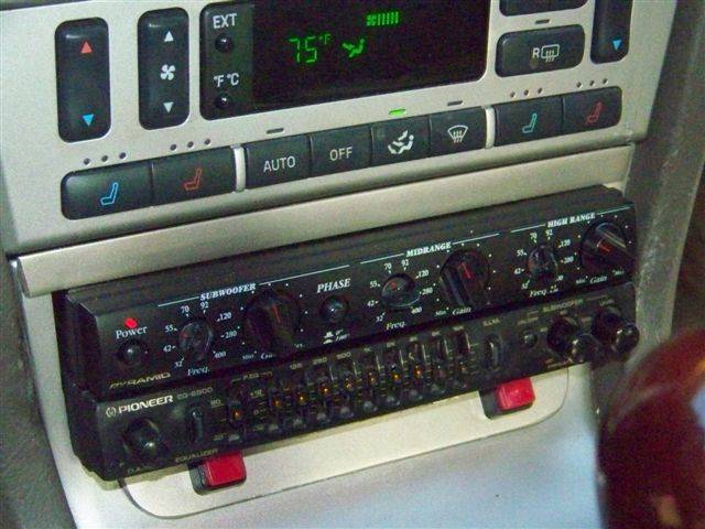

I went a bit nuts with my setup and added new wires, subs, 4 amps (1700 rms watts of Rockford Fosgate) and a din of equalizer and crossover
controls where the ashtray used to be.
This nesessitated making some new pieces to finish it off.

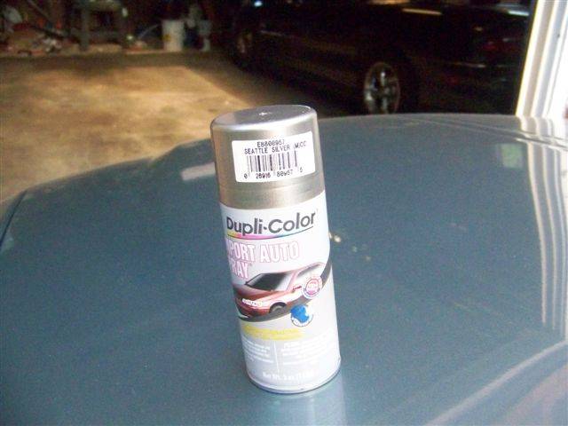

I used Duplicolor Seattle Silver E8800957 from Autozone and it is very close to the factory color.
The 2 red switches are on/off to reboot and a switch on the illumination wire that is hooked to the ashtray light wire.
The screen brightness goes to half when you turn on the lights and I don't want it to dim if it's just getting dark or if it's raining.
