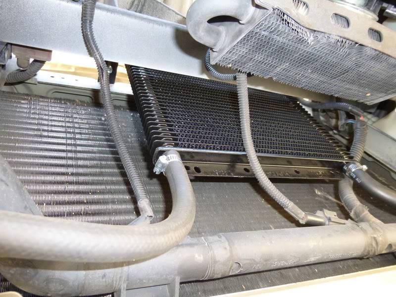

I have a hayden oc-1679, how well does it work? I have no clue, I apparently ruined my transmission before I could find out. I'll probably need to replace it or find a way to thoroughly flush it out.

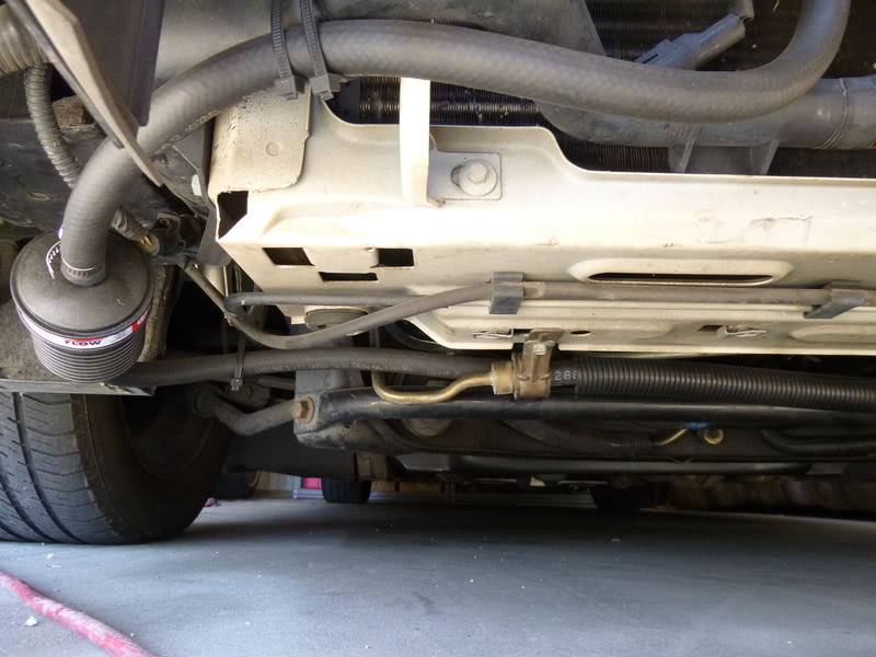

I left the stock line running into the radiator and bent a hard line to bring the out side down and around to the front then rubber lines to and from the cooler and back to the stock line (I cut it before the bend).
I plan to add a support for the bottom to keep it from flexing at high speeds.
The zip ties are temporary, I also put an external filter on there while I was at it.
ignore the bent cooler :shifty:

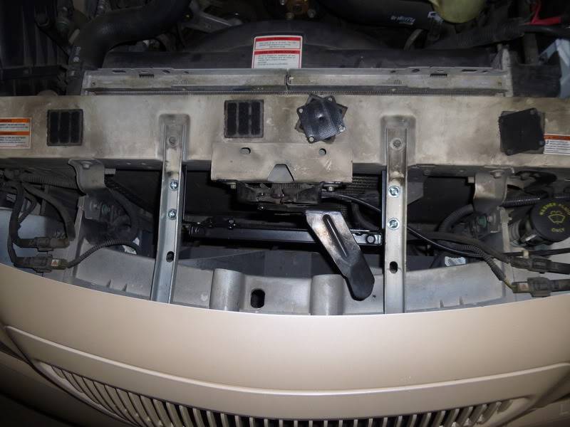

Are u talk'n bout the steering cooler? :D
yes, I hit a chunk of tire that couldn't be avoided while I was on the freeway, it split the bottom section of my bumper right in half :(
luckily the power steering cooler didn't crack or leak so I left it alone, the bumper looks like and new again though. If I ever spot a cooler in a junkyard I'll probably grab it, they are usually also bent up.
