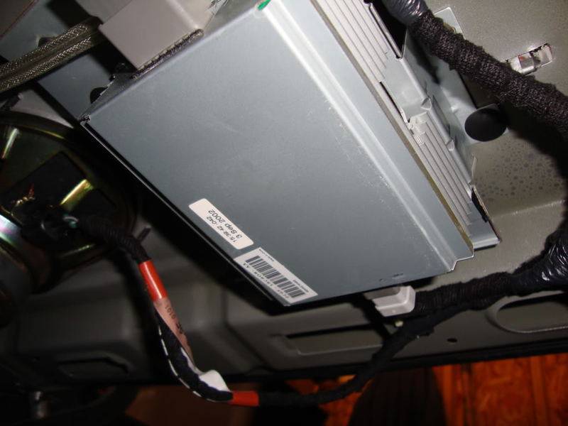

Check and see where exactly they spliced into the 6x9s... Also while you are in there.. Look for a stock amplifier. If it has a sub amp it will be the small unit attached to the bottom of the rear decklid in between (sort of) the 6x9s.

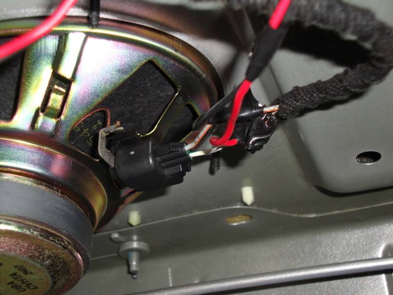

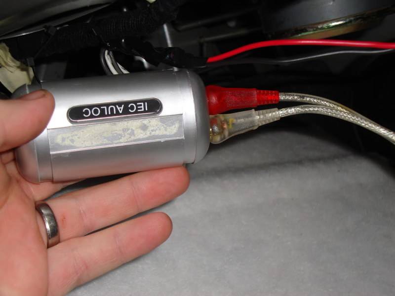

Here's a couple of photos showing what I have going on. The spliced wires run into that silver box looking thing. Also the cheapest stocker that I have seen on ebay is about $150. Wouldn't I just be better off getting a good HU from somewhere?
Where are your spliced wires going to? And what are those RCAs connected to? Both sides.. what is that silver thing w/rcas in it? and where are they spliced into?
You can get a custom box on ebay that saves all the trunk space and still have a good sounding system.
Yup you have a sub amp back there. So basically you need to take off the electrical tape that someone half-assed with that splitter and resolder/attach the wires back to the 6x9s. I am betting they are just jacked up and not making contact any longer.

The RCA's just dead end into that silver boxy thingy. As far as the other end, not sure yet. I don't know how to pull the HU. I will try to get a better picture of the wires feeding into that silver box. The spliced wires come from the 6x9 to the silver box, don't know why. DMM? Multi meter of some sort? Sorry for my lack of knowledge guys but audio/electronics isn't my strong suit.
The silver box is a LOC.. line out converter for the RCA rear signal.

You need to take off all of that grimey electrical tape that is on those spliced wires by that 6x9 sub. I bet you will find a hack job of a connection.

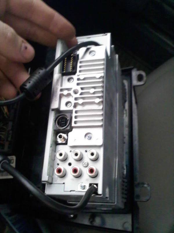

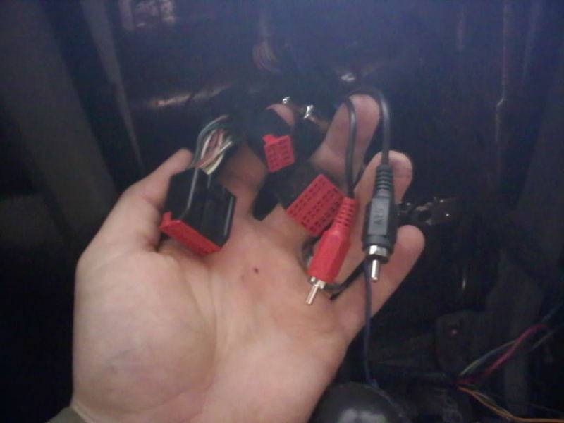

So here is what I have going on so far. Took the HU out and found the other end of the RCA's TADA!!! Disconnected them, figure I am not using them anyways.

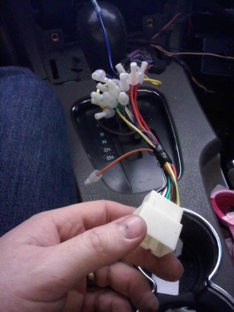

I have the three plugs for the stock unit, do I need to splice any of the after market wires into it so that the rear subs and amp will get the power they need or should it already be getting power? Or do I just need to order a new harness? The attachment is of the after market harness.
And just because here is the back of the HU
