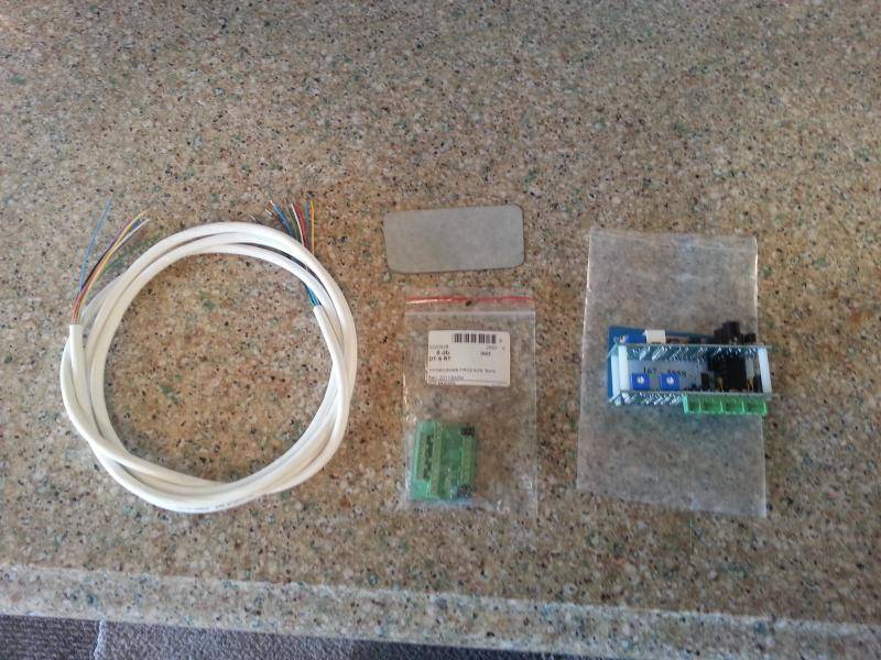

My Asham 8 arrived today and it was professionally packaged! It is smaller than I thought. Makes sense if it was designed to go in the ashtray spot. Plan to install this weekend.

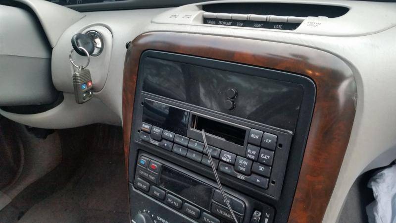

Same here. I have installed a single din radio to provide the space for the module right at the top centre where the double din was.
Next steep get a radio delete cover and dremel out the holes for the buttons and LED display. I would like find a print shop that could print translucent words like "Suspension Height" etc and use the LED blue rubber cover from the radio so they match the dash color. Plan to install a switch for the park drop and suspension on/off and would like to have a cover printed so I could install led's behind. I have looked for a blue LED ring that could go around the up/down buttons but haven't found anything that would work yet.

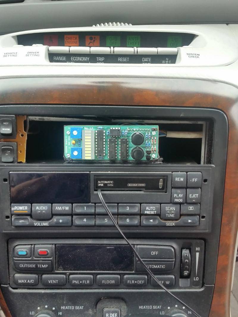

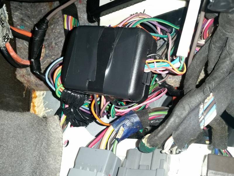

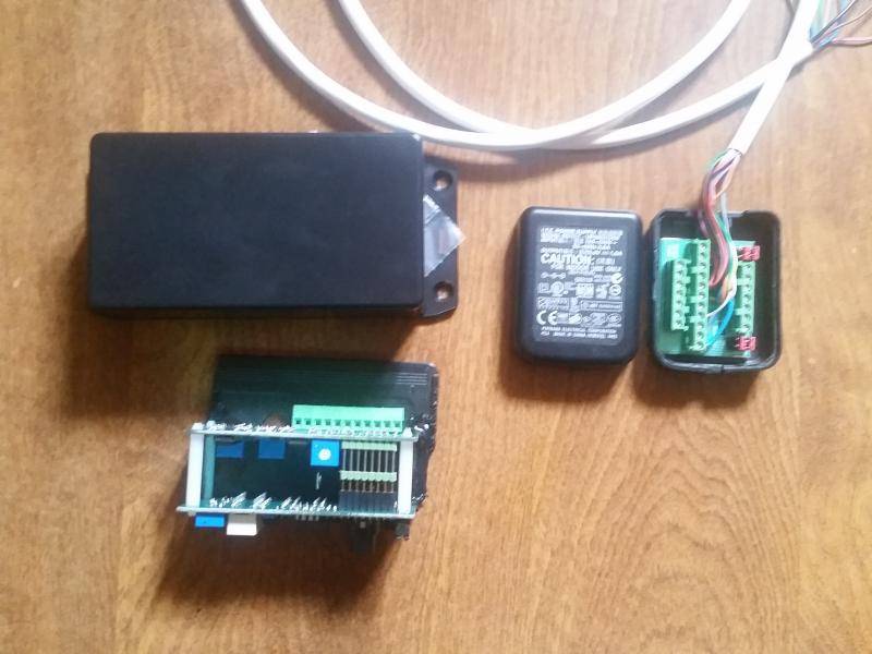

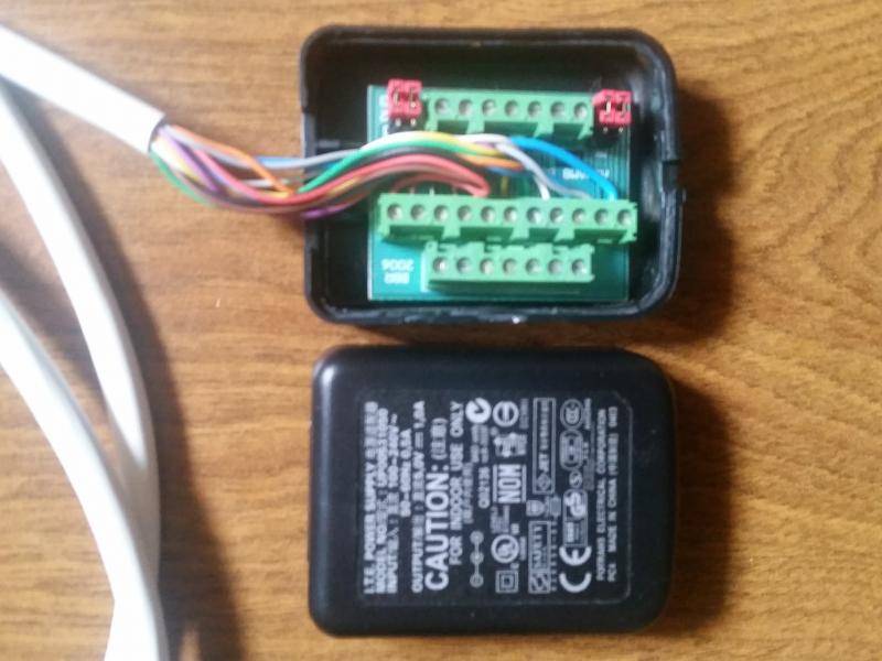

I was a bit concerned about the Asham 8 board C being open with live power on the soldered side of the board and found an old adaptor that didn't work and the case was the perfect size. Very little modification to have all the wires work. It started pouring down rain here so I couldn't tape it as nice as I wanted but will re-tape once the rain clears. I also deceived to use an electronic project box for my above the radio install to protect the electronic components there as well as behind the kick plate.

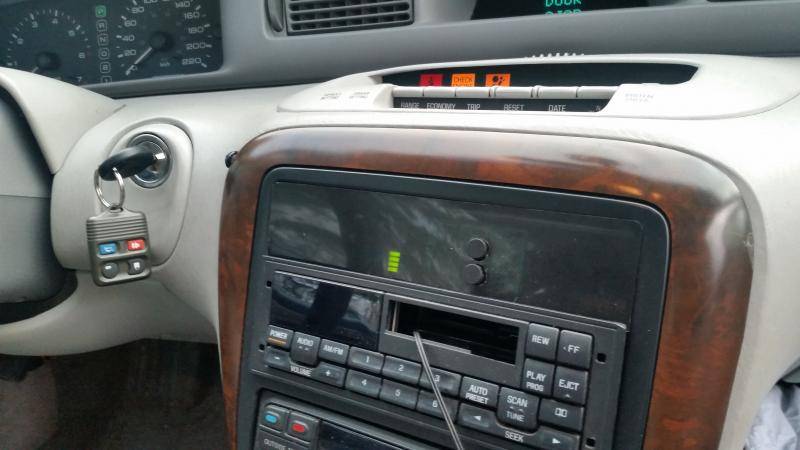

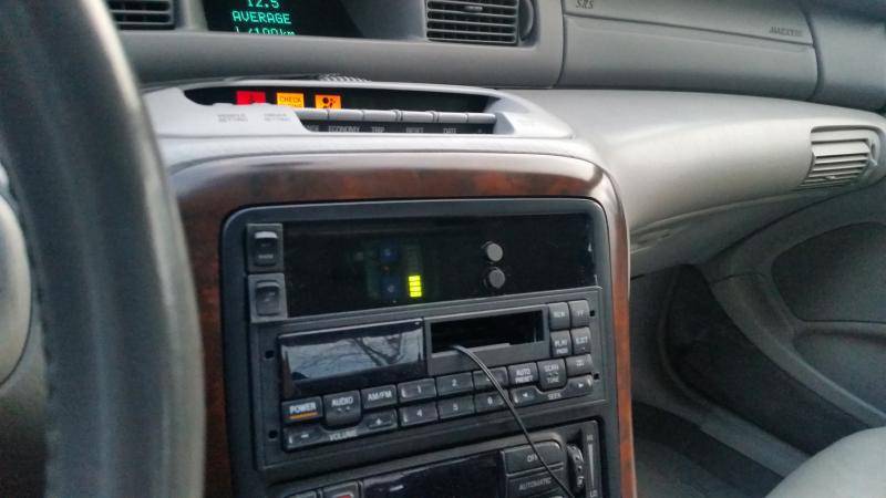

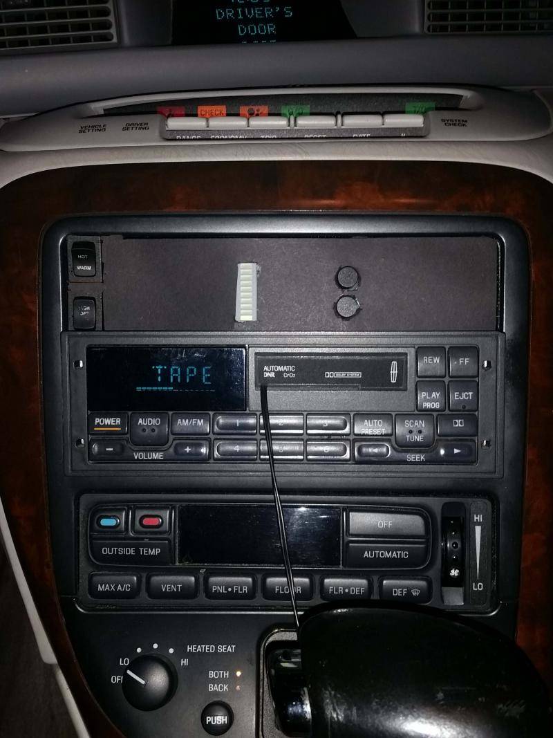

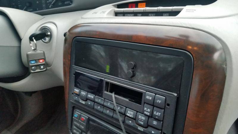

So I made a temporary cover, until I can get back to this. I did find an individual with a 3D printer, and he is looking into two color printing as he can only print one color currently20150511_000558 updated.jpg
That looks great. I just put mine in my ashtray compartment of my black 94 (no room on dash with it's single din radio).
I notice at night the display is pretty bright when I open the ashtray lid, do you have any plans of covering yours with a shaded lens?
I think the original lens was shaded?
Thanks, but that is just temporary, my plan is to have a faceplate made with cut outs and white words that say "suspension" "On" , "Off", "Up", "Down", "Park Drop", and a "Neon" "On", "Off" all printed to match the rest of the wording on the dash (White with the same font, to make it as stock looking as possible.
The original cover plate was shaded green and I thought of using a old radio lens (from Gen one or two) the part that displays the radio stations, volume, "tape" etc. that way the LED's will match stock dash color (if not very close) and not as bright. I would like to centre the module more and have a single line row of switches. This way if I ever want to turn anything off it is right there at my finger tips, keeping a complete stock look.
I originally wanted the two round buttons on the Asham 8 to light up, but speaking with Bela, there was too much involved with swapping these out, so a lighted arrow above and works just as well for me.
Just getting to the second cover plate design work has been steeling most of my time. I used a 3M privacy screen protector, as it was transparent to translucent depending on the angle you looked at it.

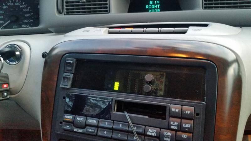

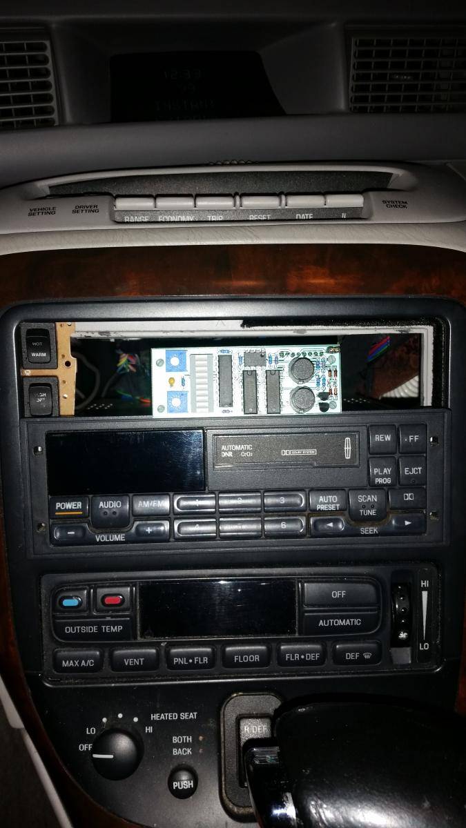

First pics are without the two switches for the suspension. Still deciding if I cut out the section for the LED's. I found them a bit brighter and more green than the blue instrument panel lights. Figured I could use the cover from an old M8 radio and put that in front so it would match exact factory dash color. Once this is done, I can get the cover plate printed, it is pretty amazing what 3D printers can do now.
