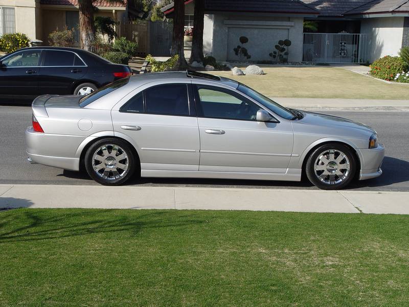

It looks really good. Enjoy speed bumps,potholes ramped entryways not going to car washes and being a PITA to change your own oil. LOL just kidding enjoy carving those corners with no body roll! looking forward to see those wheels...
Ditto what gt95 says. And welcome to the lowered crowd!!!
It might be the body kit that makes it look so low. Either way, it looks good.
I think its probably the offset of the wheels as well. The rear look a little too tucked in.
Eibach says that some cars will be lower than others depending on many factors. Yours probably dropped like 1.25" instead of 1" like they mention. Did you do a measurement before you did the drop? When I added the Eibach's to my LS the guy that put them on measured the before and after affects. Mine measured a little over 1" in front and back. After driving the car for about a week and letting everything settle it dropped another .1" all the way around.
I think it looks nice. Are the calipers painted too? If not paint them black or something.
