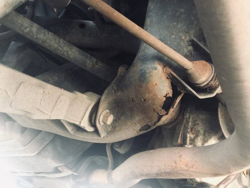

Going to need a rear subframe swap soon and wanted to check on this to eliminate issues. Is the Thunderbird the same as Gen 1 LS ? Thanks to anyone who has looked into this and replies.
I believe the Gen 1 of the LS is the same as the 2002 Thunderbird , & the Gen 2 is the same as the the 2003-2005 Thunderbird. Also, the Gen 1 S-Type might be similar enough to swap, but can't confirm. Tijoe would probably be the guy to talk to about this
I found a cherry 02 T-bird subframe..but didn't know if any LS subframe will interchange as its opens up more options on getting a good deal on one. I have a Gen 1 LS.
Is the frame itself damaged, or is it the bushings?
Frame rot on drivers side..the rest of it and the bushings are in great shape. I've been wanting to pull it and paint the frame and swap in a lower ratio V6 rear anyway so this was just an added expense. May have the replacement frame powder coated as well.
Sounds like a good plan. Since it's a Gen 1, you could swap in a Truetrac or Torsen LSD too. Way cheaper than the Gen 2 option (Quaife)

I was asking about Gen 1 and Gen 2 LS frame differences. I just need to swap the frame itself and was wanting to know if all LS's used the same frame to have more buying options etc. I'm swapping in a V6 auto rear pumpkin..same unit just a lower gear and only $200 shipped.
I repaired a 2000 with a Gen 2 rear subframe. The only differences I was able to see were the E brake cable guide or mounts, but it all adapted nicely. I also bought the S type subframe mount bushings, since Ford did not resolve to that level, it was a whole subframe for 2K USD at that time, then not too long afterwards, they were not available, period. I got a deal on mine, it came with control arms and knuckles off a newer car that found its way into a junk yard at a young age.
