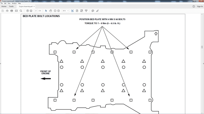

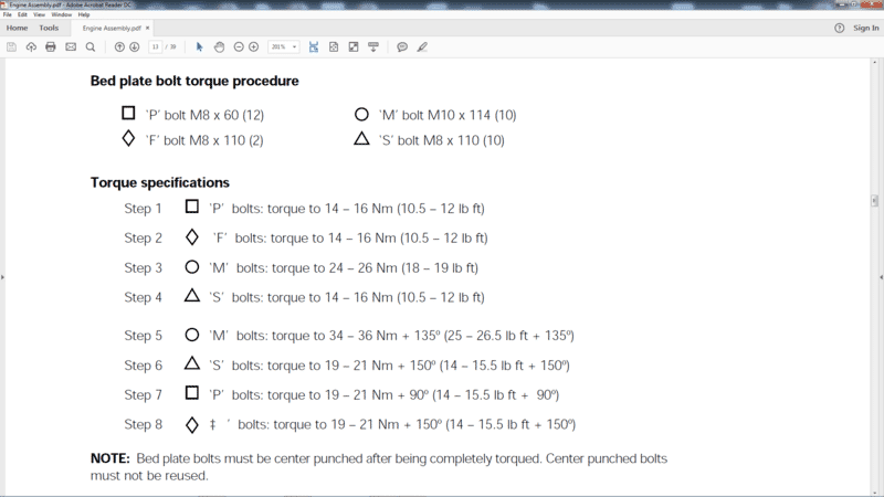

From what I read in the engine assembly pdf..
Bed plate bolts must be center punched after being completely torqued. Center punched bolts
must not be reused.
I took a quick look at the ones in mine, appears the pyramid indicated ones are punched.

So I got back with ARP on studs and they said that they made a mistake and that the M10 studs are a stock item for another engine and they are only 10 dollars each. That drops the price substantially, but the M8's are still 80 dollars each! Is that diagram from the Jaguar engine?
Yes, but from what I have been told the bottom end is the same.
