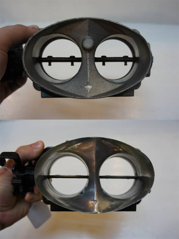

Hmm, looking at Mach 1 intake for the DOHC 4.6, it appears it's throttle body has both blades opening in unison, as it has a shaft running through the entire center section that the blades are attached to. Here's a pic of one (top image is a stock Mach 1 as far as I can tell)
Makes you wonder how much of a gain is from the different TB vs. the actual intake between Mach and non Mach (aluminum, not plastic)? Aftermarket TB for the Mach 1 also go w/o any stepping as far as I can tell.
