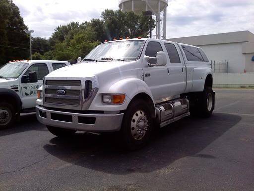

I worked on their F650 today. What a peice of :q:q:q:q... I hear they are in town doing a show at Jimmy Johnsons house, thats why the truck was here.
Whoever wired the thing should be ASHAMED of themselves... Scotch lock connectors everywhere. Crap electrical taped everywhere and corrosion. Upfit wiring isnt in the Ford manuals, had to trace wires. Cheapy butt connectors had corrosion and the wires were ate away by it. Got it fixed tho. Its a 2008 F650 with a 6.7 Cummins in it and an Allison transmission.
