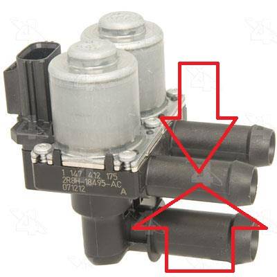

Joe, my upper right (closest to the engine) hose is leaking at the DCCV. I believe the nipple may be cracked at the unit. It produces a drip about every three seconds. Is this the hose I would need to block to keep coolant from entering the valve? I will need to drive the car about 3-5 miles to and from the body shop and don't want to leak too much coolant.

Since you have a leak, you would have to pinch off all three hoses, as the coolant would just back feed the leak otherwise. Also, I think that it would be very hard to pinch the hoses off enough to prevent a few drops from getting past. (A minor flow of coolant through the heater core wouldn't overcome the AC, so it is still a solution for that.)
I think that at the leak rate you describe, you should be able to drive a few miles to get it fixed.
