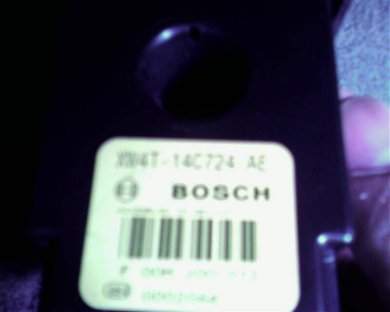

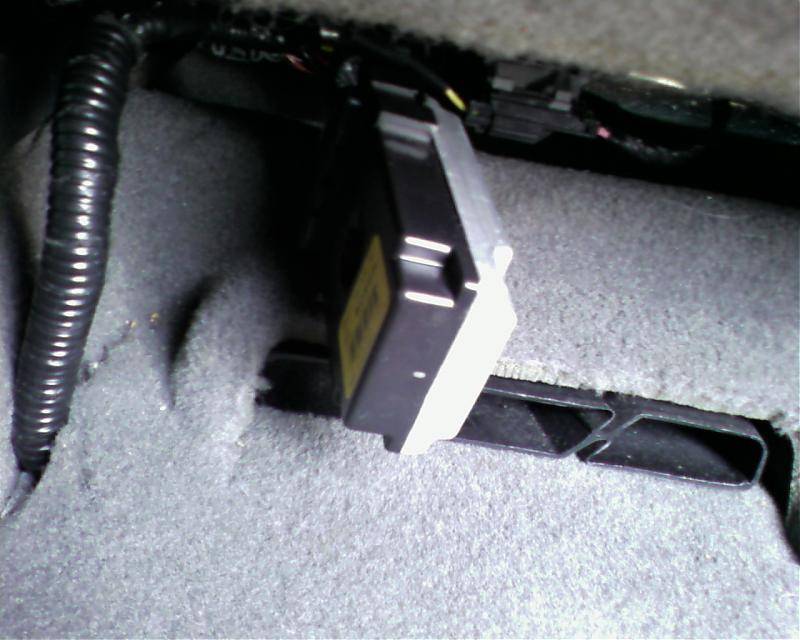

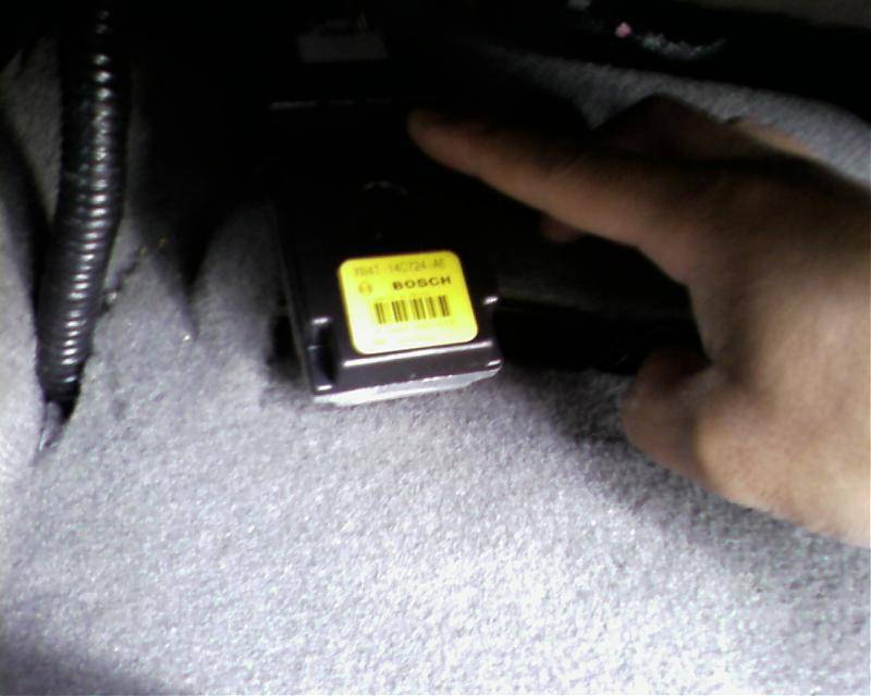

And not to bombard you guys, what is this part that is hanging off the passenger bottom? I felt the driver seat bottom and felt one there too, so I'm not sure if a clip just broke. Is it necessary to clip it back under the seat?
The part says Bosch but so far I havent been able to find what it is.
(sorry for pix, camera phone is all I had during my lunch.)
The relay in the pic is the Seat heater control module p/n XW4Z-14C724-AA and has a list price of $103.57 and LVC cost of $77.68. The elements are YW4Z-14D696-BA for the back and YW4Z-14D696-AA for the cushion and have the same list price of $43.72 and LVC cost of $32.79 each. All are available through Ford at this time. The elements are buried in the seats but pretty much accessable, so I am told.

So the relay can just stay as is or should I make an effort and clip it back on the bottom of the seat?
