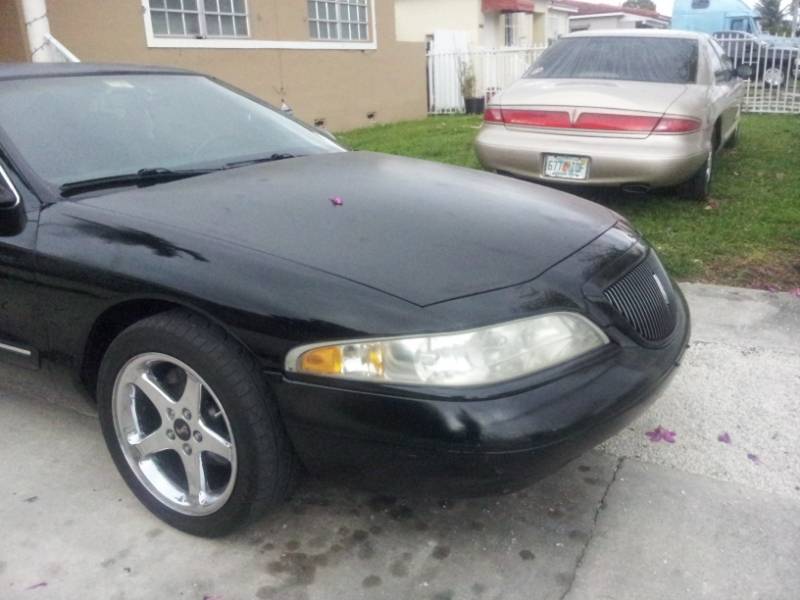

Guys, my passenger side headlamp has slowly started to get crappy. I've restored this headlamp 3 times since I've owned the car & the last time I restored it, the haze barely came off. Most of it is on the inside. That being said, I've got a couple headlamps in my sights but they're too expensive. My driver's side is very nice so I have no need for one. Just the passenger. Please pm me or email me if you have one you can ship to me for a decent price. Thanks.
UltimateSVT@aol.com
This picture shows the headlamp in it's best shape. This is the best it can look.
I've never seen that before, I've seen stress fractures from heating and cooling of the lens.
Have you put a cloth or anything on something like the eraser end of a pencil to see if the inside wipes clean?
The reason I ask is a guy that works for me had his mother come visit this past Christmas, she has a 97 and both headlights looked like that. I clean up the outside with no luck, pulled the headlight out and sure enough it was on the inside. I ended up pulling the lens apart.. cuz I can do them pretty quick now. Turns out it was salt, yes I tasted it. Both vent tubes were missing from both lights. I cleaned them up and put them back together with new vent tubes.
She lives in Miami, the only thing I can think of is it was from condensation. I remember when I lived in Sarasota and Bradenton, my windows looked like that almost every morning.
Just a thought.
Well, I always noticed yellowing on the inside of the lens since I bought the car. Restoring the lens always helped but it's just fried from years under the sun I guess. Due to the mileage & the story behind this car. It sat for years outside the house under the sun. When I went to their house to pick up the tittle, I noticed the car was parked facing west.
