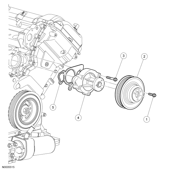

What are the odds of it being the blocks flange having a crack in it right up around where the pump bolts on?
The leak seems to be coming from right about here.....

I think that those odds are low, but not impossible. To me, water pump replacement on the LS is pretty easy compared to several other cars. You just have to drain it, get a few hoses out of the way and take the belt off.

It looks like there's a TON of stuff in the way. Do you have to pull the radiator and fan out or no?

Wow! Well maybe this won't be as disastrous as I feared.

I'll bet it's a lot of work to pull the damn water pump off and replace gaskets, isn't it?
No. The water pump is one of the easiest things to change on the LS. You don't even have to take the belt all the way off... once you get the air cleaner box out of the way.
New dealer pump comes with rubber embossed steel gasket already on the pump.
All the bolts are torqed to 89 inch pounds. Save the pump pulley bolts till last, before you put the belt on... then use hand pressure on the belt to get the proper torque. Or use a strap wrench.
