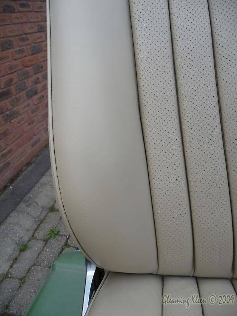

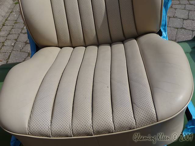

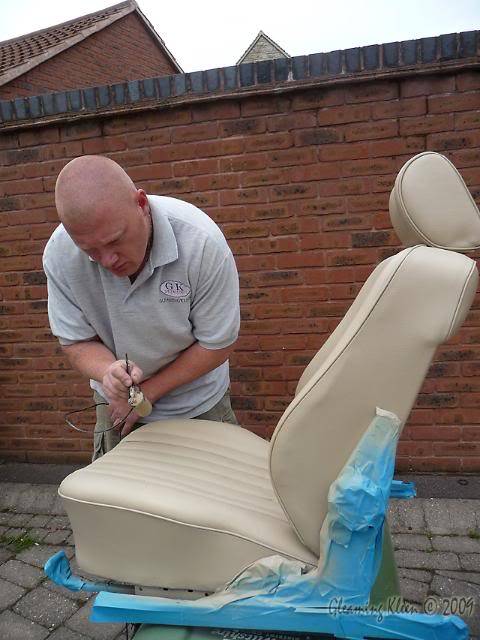

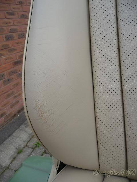

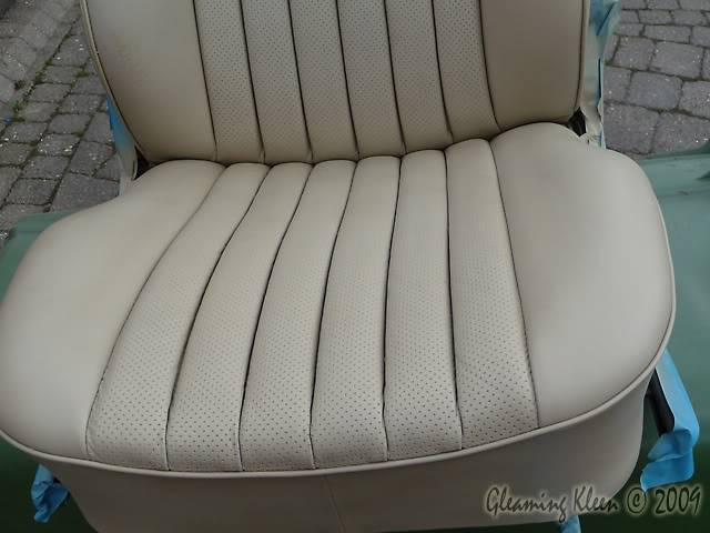

Check this out. These are some of the results the professional detailers are getting out of refinishing leather:

I wonder if it still feels like leather, or if it get stiff..like painted vinyl
I would guess it would feel about the same as if it were new. I mean, coated leather don't feel like suede to begin with.
What I do wonder about is if you would care for restored leather the same as if it were a factory finish.
Man those were some nice before and after pics. He did a great job on that car. Is that what you do pektel? How much would a job like that run at?
Not to be negitive, but it doesn't last. I worked at a dealership and thats what we did to the used cars that would come in with worn seats. They always come back to worn fairly quickly.
Haha yeah that's what I do. Just not NEARLY to that extent. I've never encountered a vehicle in that poor of shape that someone was willing to pay to bring back to like new condition.
I would imagine a job like that would be in the 2500-3000 range. Not many people around here willing to shell out that kind of cash.
Thats a lot of money, maybe try myself first and when I failed horribly and got tired after the 10th hour I think I would.50 hrs is a long time.He even got down to the little tights places with q-tips geez. That is a lot of money but the outcome was great.
