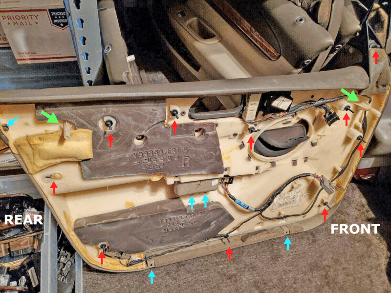

I'm attaching a picture of the passenger door panel. The alignment pins are the green arrows, the clips are red, and the screws are blue.
