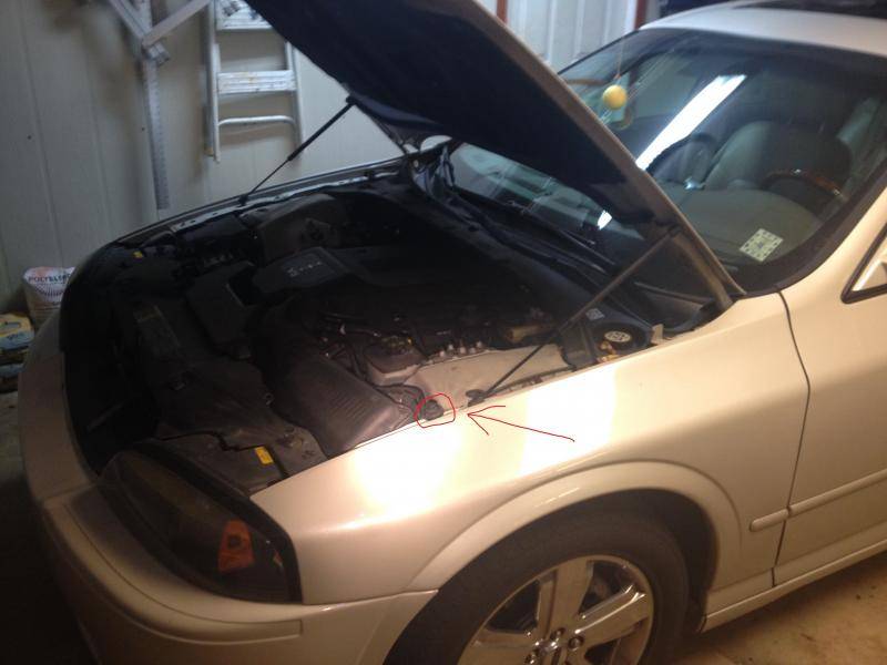

Are you pushing down the correct thing? The switch is here, in the red circle.

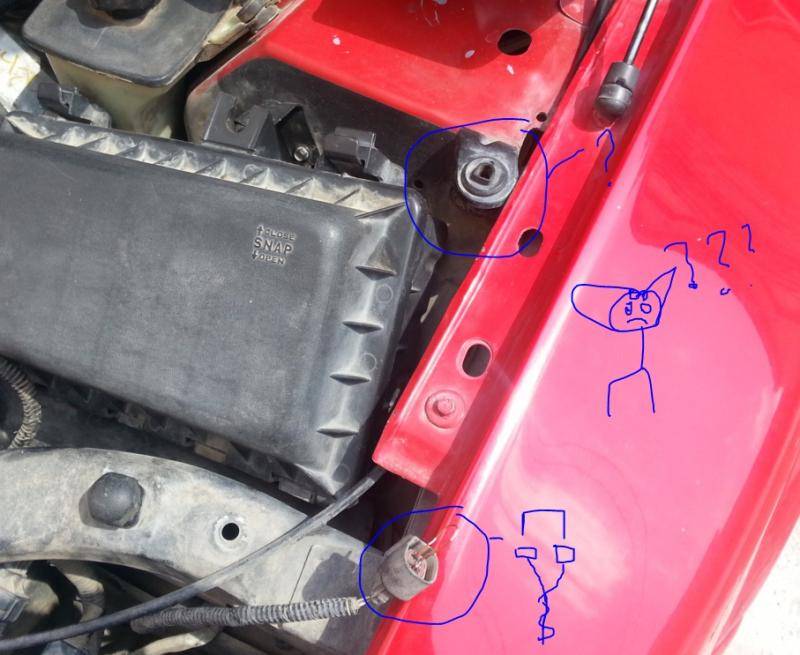

Dammm !!!
I tough it was unter the lock .:slam
I have not that switch just some king of plastic cover.
---Looking for a loose wire i found one with 3 connector , 1 for MAF sensor , 1 for IAT sensor and a loose connector. (2 wires white and black/yellow )
Measuring voltage - just groung , so i put a jumper wire , now its working.
1 beep and 1 flash.
Of course , the hood sensor now its bypassed until get that sensor switch.
