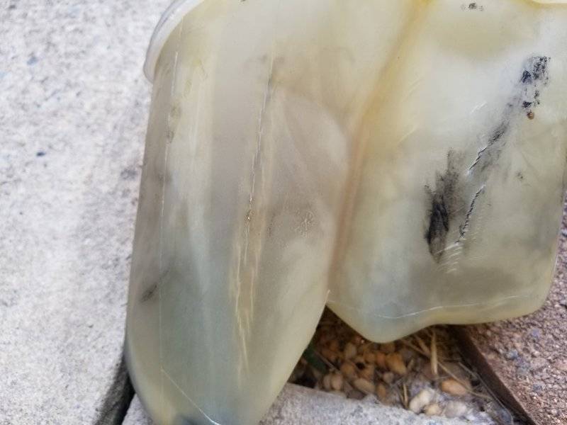

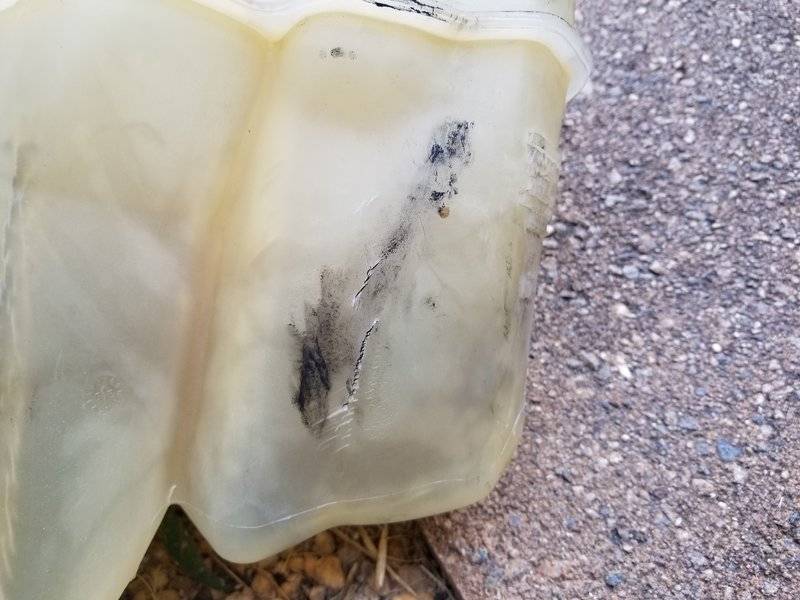

Told ya about the degas bottle micro cracks. Now think of what the rest if the insides of the plastics might look like.
Yes, the Degas didn't look too great..

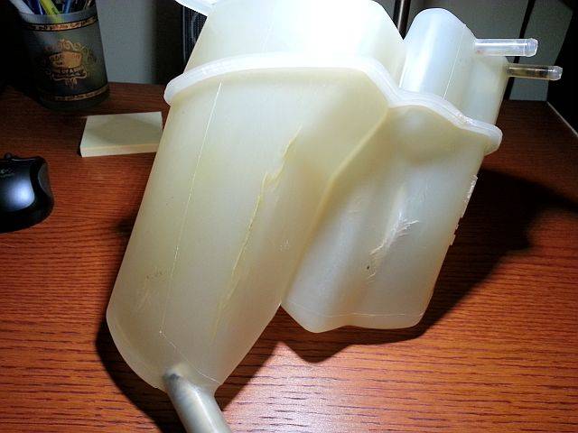

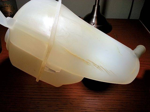

I'm so terribly sorry but I must laugh out loud. We keep telling folks, it needs to all be rebuild at the same time.
These plastics eventually begin to look like this on the insides.
It simply rots away over time. Unfortunately this time is around 100K mi or +/- 10yrs.

From looking at those pictures, I'd dare to suggest your inlet pipe is leaking from micro-cracks on the underneath side ... just a wild guess.

I would say that's a pretty damn good call, Joe! Althought, maybe it just finally got WORSE and now I am able to see the spray more visually. The pictures that look like old spray were kind of hidden, as I had to snake my phone down and around to snap a photo.

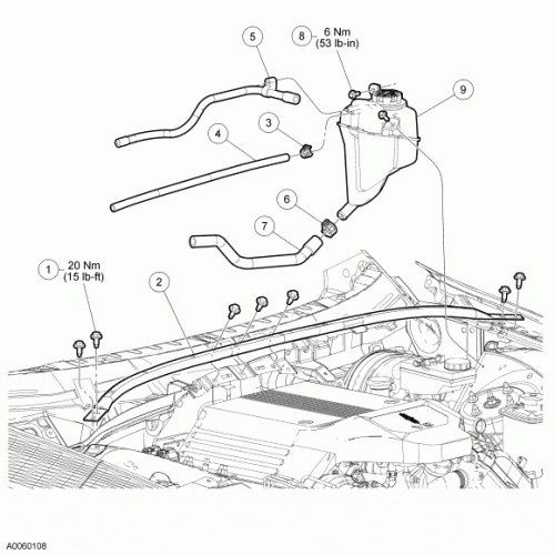

Take your wipers off and the cowl the hose going into the bottle follow it back there is a double clip on the line mine was loose and had a leek

Degas tank (cracked all to hell on the back side)
