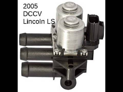

    And if the air goes from cold to hot when set to cold, how can I further be sure it's the DCCV? I kind of know where it's at. Is there any way to tell by measuring temperatures from it's hoses? I hate to sound like a dummy but it looks like it has one hose coming in and two going out, the 2 going out being one above the other or possibly next to each other. What should the temperature of these hoses be? Or is the test you spoke of good enough for me to go ahead and change it out?

    Sorry it actually appears that there's possibly 4-6 connections and I really don't know what each one is. How can I 100% diagnose this though? You've been amazing so far, thank you

    If you have a 2005 LS V8, then the DCCV is this one.
    There is one in port, and two out ports (one for the driver's side heater core, and one for the passenger side).
    There are no temperatures to measure. Both valves should be closed if you aren't asking for heat. If you are getting heat, then one or both are open or at least partly open. There can be electrical problems that cause this, such as the valve being disconnected or a wire cut or shorted. There are full tests to verify this.
