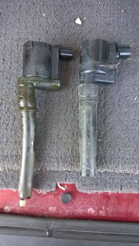

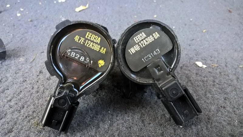

I had an idea a week or so ago when contemplating changing out my ignition coils. I headed to the Pull-A-Part nearest me to investigate and look what I found.
On the left is a coil from a Lincoln Aviator, on the right an LS coil with a broken hold down tab. The 4.6 DOHC uses the coil cover to hold down the coils, so the hold down tab is absent.

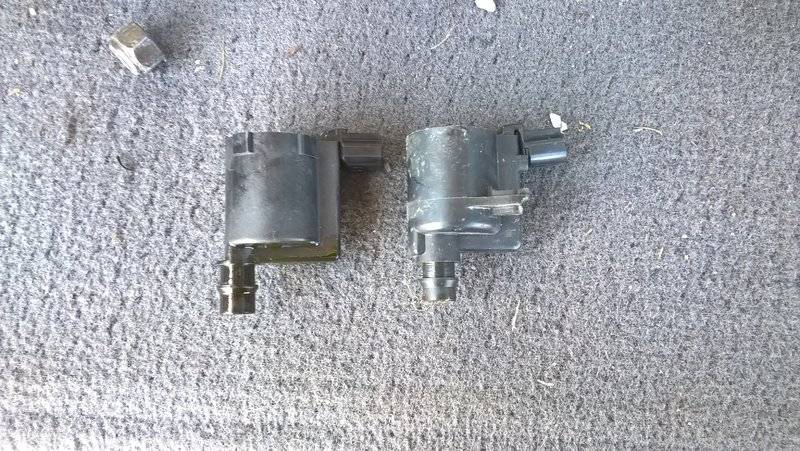

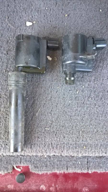

With the boots removed we see how they are dimensionally very similar

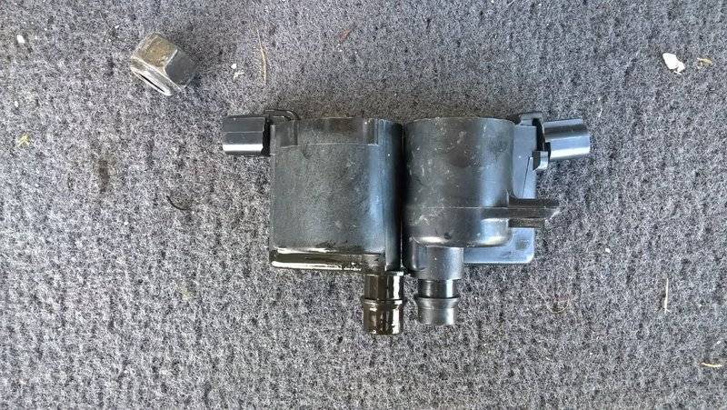

And finally one with the LS boot installed
Has anyone used these coils as a replacement for their LS? I know a few guys (cammerfe) were using the 4.6 SOHC coils but stated they wouldn't fit under the coil covers because of the angled connectors.
I also remembered that they had to reverse the wires in the harness to use the 4.6 SOHC coils, I expect that these would be the same way. I know of guys on Corral.net that went from SOHC to DOHC engines in their GTs and used the same wiring harness. They didn't mention anything about reversing their coil wires so until I can find a wiring diagram for all three cars I won't know for sure but would bet the polarity is the same as the 4.6 SOHC coils.
