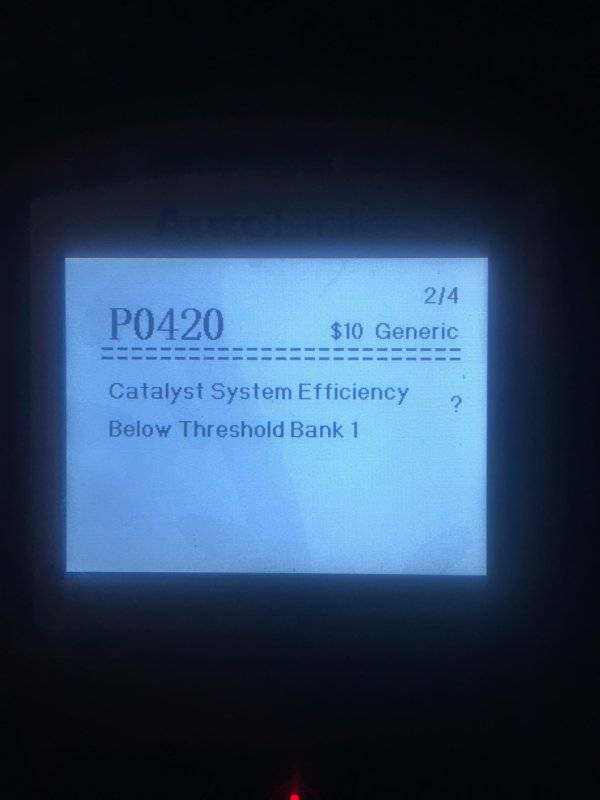

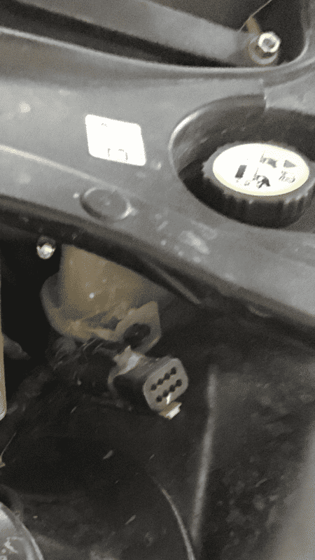

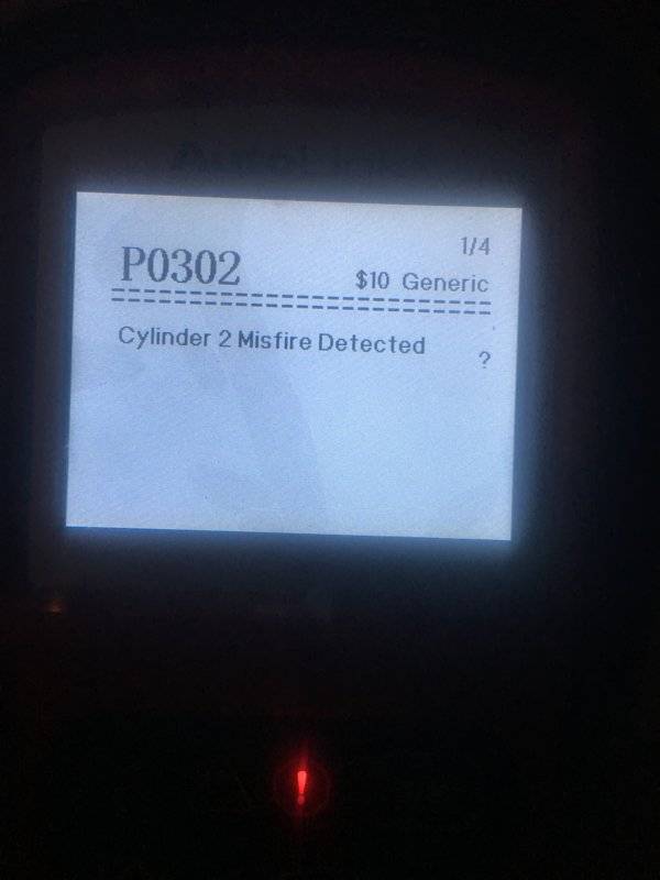

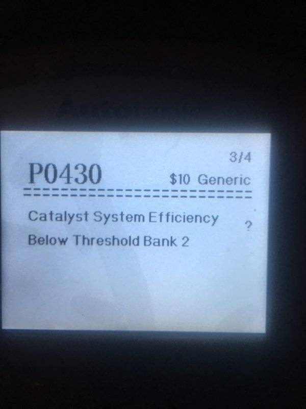

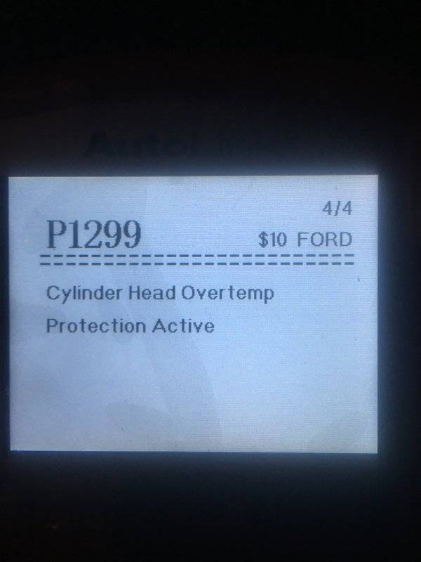

***I'll include pictures of codes I pulled tonight and a pic of the part the "backyard mechanic" said he cleaned out the rust and he thinks I may need this to keep my car from overheating, but that my car may be fine with the part he cleaned and reinstalled. I guess eBay had one for $125 used.

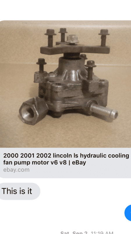

1) How do I bleed the system correctly? The bleeding hose next to the degas bottle? 2) my fans seem to work. The guy who worked on it a couple weeks ago stated it may need the part pictured. What's your opinion?

The fan does work. Seems like it's working adequately. It speeds up when the AC is on. The guy who had his hands on it last stayed that it may need the part pictured above. He supposedly "cleaned" it out(said it was rusted). Also, is there 1 or 2 fans?

More likely to need the actuator on the pump, than the fan motor - if there is a problem with the hydraulic fan.

Where is the coolant leak? You need to first hunt down where the leak is coming from and when was the last time you checked your Thermostat...how old is your thermostat and if you are getting catalyst codes you may need a new catylatic converter, if the exhaust has no where to escape it will make your engine run hot and more than likely over heat...what does your exhaust system look like? Start there first maybe ...just my 2 cents on what I can follow on this thread
