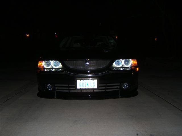

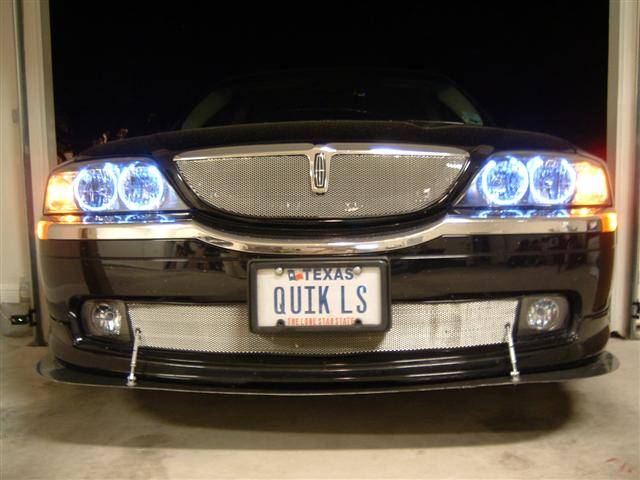

these are not LSK's but similar technology.
The top is the newer style LED rings
The bottoms are the CCFLs
big difference with CCFLs being much brighter, more durable (i went through several LED rings) and more OEM looking.
the picture do not show the contrast in brightnbess as much - since the LED shot is in the garage with the lights on. The CCFLs are bright enough to be visible during the bright Texas days.

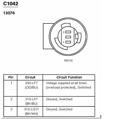

Is this the connector that I'm going to need to tap into when I install my angel eyes?.. Well not the actual connector, but the OG/BU(#1) and the BK/WH(#3) wire?
To tap into the parking lights you will need to tap the positive (+) to the OG/BU wire and the negative (-) to the BK/BU. The BK/WH is the turn signal wire. You don't want your angel eyes blinking when you turn do you? :D
