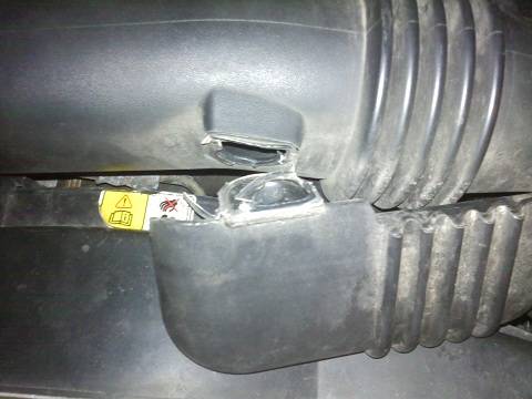

this is on the intake tube between the air filter box and the throttle body
this was almost completely off and then tore off completely when I bent it a little.
i didnt even know what this device was for, just learned about it.

could this be my problem or part of it?

ABSOLUTELY!! Unmetered air is getting into the engine and the PCM doesn't know it's there.
wow cool. i really hope this is most of the problem. I cant wait to change this out. I cant remember how long it has been since the LS has run correctly. almost a year. i wonder if I can plug this hole until the part comes in?
Yeah, all that is that's broken off is the intake resonator which quiets the engine revs. I've seen a members cut those off and patch the whole with a bit of plastic and an epoxy.
