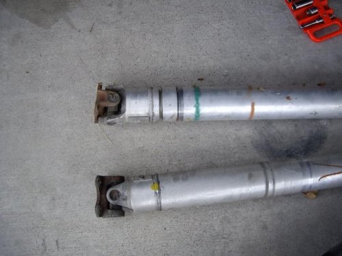

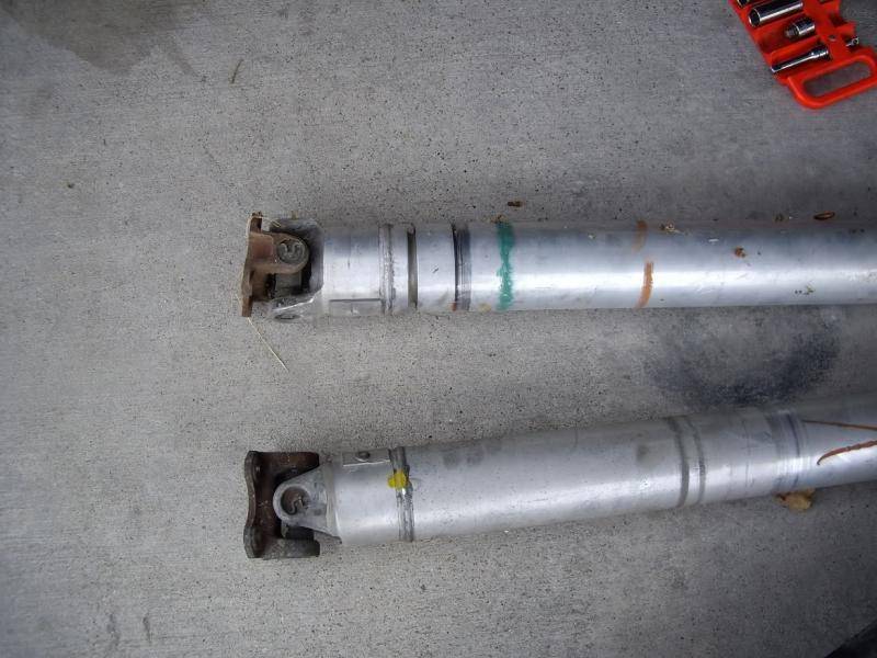

Swapped out the steel driveshaft for an aluminum one from a mark 8. I used a driveshaft from a 93' mark 8 but looks like the same 2 piece shaft to me. It was a fairly easy swap, just got to swap ends off from the old steel shaft which was no big deal because I was going to replace the u joints anyways. One of the reasons I did this was because my old shaft had a bit of vibration, which could have just been from the worn u joints. The other reason I did the swap was because of the weight savings. I dropped about 9-10lbs from the swap so maybe gained 2hp and 1mpg. The length is nearly the same only like 1/8" shorter over the original either that or I suck at measuring. I spent probably 3-4hrs because I'm slower than molasses, but shouldn't take more than 1-2hrs for most people I would imagine.
