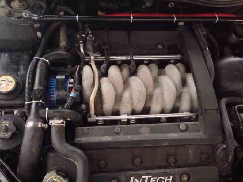

    I was told my continental wouldn't like an aftermarket alternator either but my 275a Singer alternator works just fine.

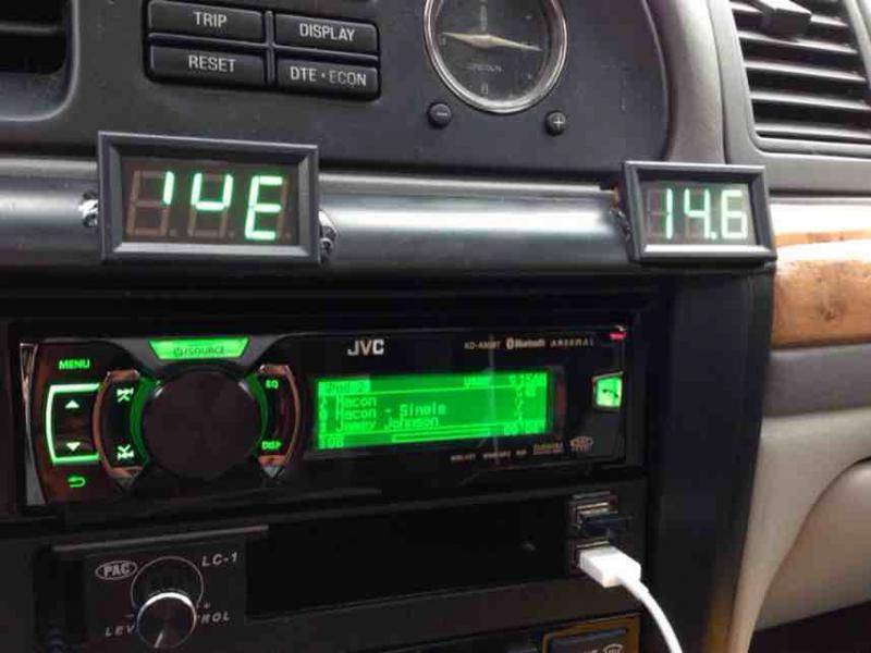

    I understand that - different platforms, different eras, different electrical systems. As an audio enthusiast/basshead the electrical system of my car is absolutely vital. My alternator cost a nice $500 and is one of the most reputable high output alternator brands on the market today. Cheaping out isn't an option when current draw can exceed 500a, nor should it be with any cars electrical.

    The thing is that almost no aftermarket brand works correctly with the gen I LS's odd PCM control scheme for the alternator. I have heard of one aftermarket that worked, but that was only because it used the Ford "voltage regulator." As such, I don't think it put out much more than the stock alternator, so why not just get a quality rebuilt Motorcraft and be done with it.

    To my knowledge my alternator uses an OEM casing and voltage regulator, just beefed up everything else, essentially.

    It won't matter on the Gen 1. Long story short, the LS computer controls the alternator's output directly. It is not controlled by a dumb regulator like it is on most other cars. Now here's the important bit: on cars that use the computer to control the alternator, or a smart regulator, the computer monitors the system load and increases or decreases output accordingly. On the LS, the computer does NOT monitor the system load. Instead it uses an internal power map to decide what the power load SHOULD be according to the parameters it was loaded with and that's the power you get. If you add a huge stereo system to the LS then the car doesn't know this. If the computer thinks the system load should be 27 amps but you have a 500 amp stereo system installed, you can install a 2000 amp alternator but the LS will still only allow 27 amps. Even the LS "engineers" realized this was stupid and changed it back to a more conventional system for the Gen 2.
    About the only way around this is to put a second alternator on the car, and build a completely separate system to power your stereo system. People have been trying on this board to find a way around it for as long as I've been here, but it requires access to the power parameters and nobody's cracked that yet. Unless you know a computer guy who can crack into the LS computer, that is. If you do and you guys can come up with a product to allow total access to the LS computer, you'd make a couple of bucks as there'd be a market of about 50 people for it, maybe.
