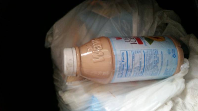

Alright I really appreciate the help ive never had a hydraulic fan before so its kind of new and I bought the car off someone that was supposedly a mechanic but its been a non stop pita, its been one fix right after another but after joining this forum seems like its the 1st gen ls that had the problems Ive ran into.I drained the hydraulic reservoir, this is what came out
Ya when I seen it I figured it was really bad ive never seen it that color, I wish I wouldve never jumped into this car lol, sooner or later ill have it road worthy........I hope
