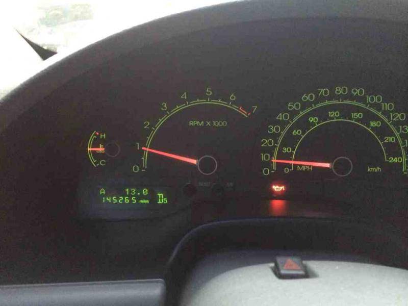

AFAIK if that light comes on you're in serious trouble... if I remember correctly when that light comes on you've already reached a critically low level of oil - low enough to seriously damage the engine. I would immediately stop driving and check the oil level.
That light really has nothing to do with oil level. The LS has no oil level sensor. That light is a no-oil-pressure light.
Reasons for it to come on:
1. Your oil level has dropped too low for the pump to pick it up. You have a leak, or you are consuming oil. Your engine has been damaged. If you turned the engine off the instant the light came on, you may be okay.
2. Your engine has so much wear that the oil flows around everything so much that it doesn't build pressure. Your engine is done for.
3. Your oil pump has failed. Your engine has been damaged. If you turned the engine off the instant the light came on, you may be okay.
4. Your oil pressure sensor (switch) has failed. You are okay and only need to replace the oil pressure sender.
I just remember seeing horror stories related to that light being on... never experienced it though.
