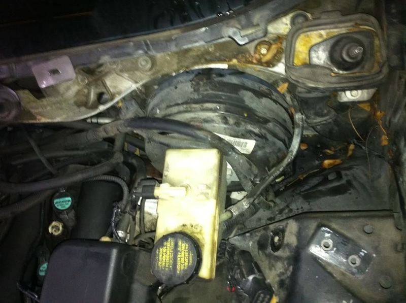

I popped the hood and something is definitely blown within the hydraulic circuit.
That came from on top so its not the slave cylinder or hose popping off the slave cylinder. Either the hose split/broke up there, the master clutch cylinder went or there's a problem with the connection between the brake reservoir and the clutch master cylinder.
Hm, Im hoping it to be a fluid line buddy. I'll took it to the garage today. I will get on it on monday and find out.

Both. I work primarily on diesels these days though. I took a look at my ls and I think id start by removing the degas tank to see if you can get a better look from there.

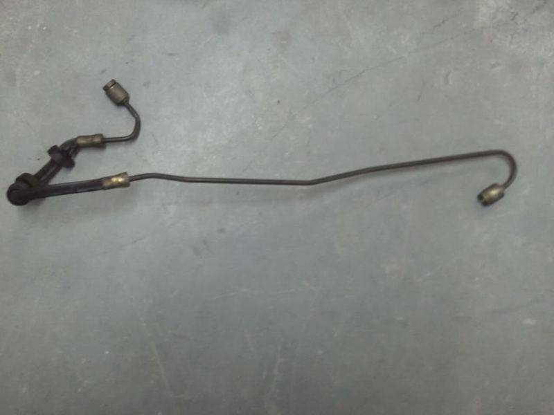

I got it. It removed the tank as you suggested buddy. Here's what I found
Costs $155 at the dealer. I got it repaired for 35 bucks. I'd like buying new OEM stuff. But cant afford it right now so I need the car up and running.
