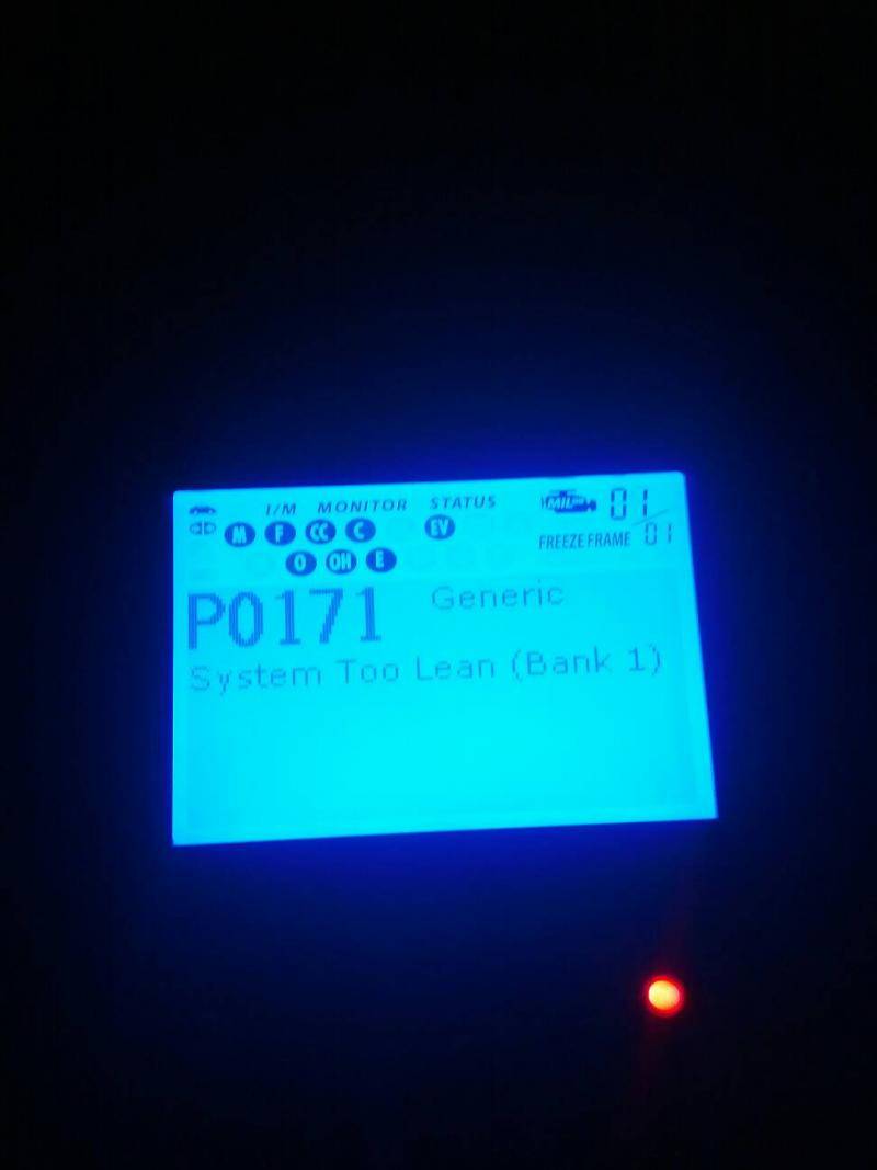

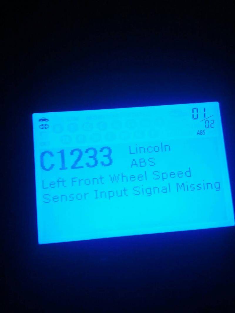

Alright bit the bullet and Vought a code scanner here's what codes I got. uploadfromtaptalk1393369793750.jpg
Well according to the above codes it looks like there may be hope! Maybe the old owner used cheap 87 gas? Its quieted down a bit after putting in 94
I don't really see that. (Yes, it will help to put the right gasoline in.)
The lean code could be due to bad COPs and/or you may have an intake air (vacuum) leak somewhere.
The wheel speed sensor problem is not unheard of. At worst, you may need a new front hub to solve that. Certainly, whatever you have going on with leaking caliper(s) is a bigger issue.
I'll do a smoke test on it tonight to find any leaks
You could also try removing the speed sensor and shooting a little WD-40 in the hole. I think I read Andrizzle doing that in another members thread. I had the same code and hit it with a few short bursts and no more problems.
To the OP, the wheel sensor is easy to locate as it is the only electrical wire running along the brake line right into the back of the hub. It is held on by a squarish retaining clip that you pull up with a screw driver and pull the sensor out. Shoot the WD-40 in and reverse the procedure.....20 min job tops.
If not it could be damge to the wire, the wire connector which is behind the wheel well cover, or just a shot sensor/hub. But 20 minutes and a $4 can of lubricant can be a time/$ saver.
Hi there, I just did that wd40 trick and it worked! No more code for that.
