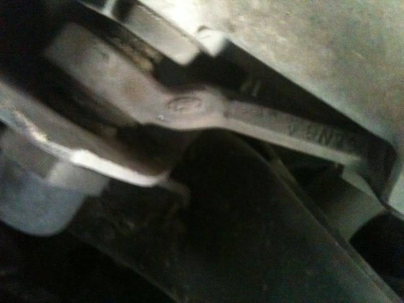

Toe Link compensators are probably shot.. It's a piece that's fitted inside the rear LCA... No longer available and nobody has come up with a fix as far as we know.. You can try to cross the bushings with another vehicle and have them pressed in...good
Luck
Oh what was that? That just how it is, and its fine? Good, just what I wanted to hear! lol
It fits with the LCA in the forward bolt hole and to the frame
Luck
Huh?
They're installed on the outside of the LCA, between the side of the LCA and the forward mounting bolt.
Moog K8594.
Andy, What does the sheet that you got with your alignment say about the rear toe in? The toe links are there to control excessive toe changes while braking or accelerating due to the soft LCA bushings, but are not adjustable. The rear LCA bolts adjust the toe.

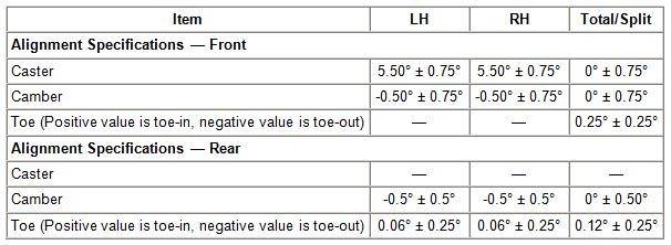

Here are the factory specs:
Hmm.... good to know factory specs anyway.

A lot of shops have alignment machines that are out of wack and the techs don't know how and when to compensate for it. If you get a chance to shop around try focusing on shop that has a Hunter Four Wheel Alignment Machine. Be sure they are comfortable aligning 4 wheel independent suspension cars. Also note that some machines have specs stored for the Mark Vlll that are different than those DLF posted from the shop manual. I prefer staying to the shop manual specs.
Can I walk into the shop with those specific specs, and ask them to align to those numbers as opposed to what's stored in the machine?
That is exactly what did, after I noted a difference in the stored spec vs what I had.
