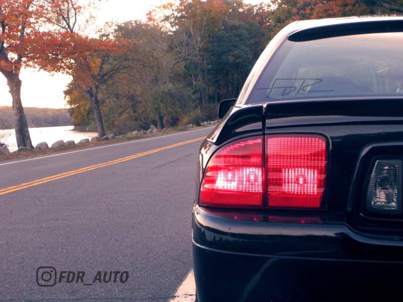

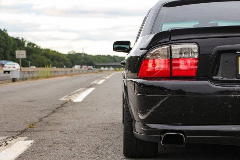

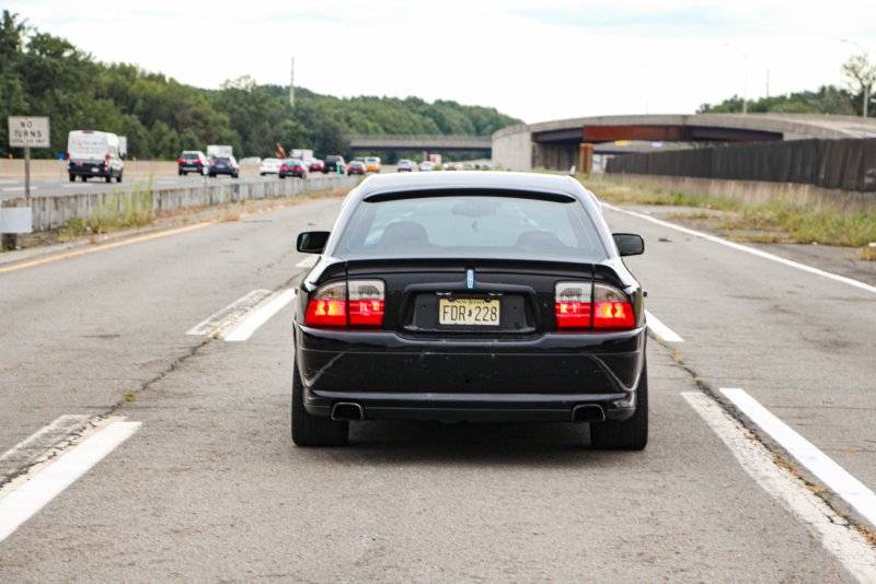

Euro rear: The rear has a pair of prototype Euro inner tail lights (diffferent from Japanese), standard Gen 2 outers, and the Euro license surround. Japanese inners are just like American, but clear tops. Euro takes that but makes the red bulb a 3157 for rear fog use and adds a 3156 reverse light to the top since the license plate would interfere with the American lights.
Exhaust: Muffler swap, tips, bumper cuts. SLP LM2s were too quiet for a generous member we used to have, another Devin, but I find them perfect on the LS with the factory resonators. The Magnaflow kits have a certain popping or clapping I'm not a fan of, which I believe is specifically canceled by the resonators. Tips are 2014 Saleen Mustang tips. I thought they mirrored the tail lights nicely, but I can't deny I often think about going with standard quads. The bumpoer was cut up to about the metal bumper frame. Gen 1 people, go ahead and cut the bumper. It's such a visual improvement.

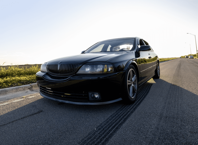

Aesthetics: Wings West rear spoiler. Gen 1 LSE front bumper. Gen 2 headlights and header panel with an adapter pigtail. Non-LSE people: paint your door sill covers flat black, get rid of that faded plastic look forever. 03 Mach 1 Chin spoiler cut down on length and sliced behind to flex wider. Some older pics feature a roof spoiler as well, some original SPoilerKing I think. The body tape wore out so I peeled it before I lost it. 50% tint on the sides and 35 on the rear glass, just to clean up the look bnut not get pulled over all the time.
I have all red LSE rears on my 2004 but not sure of the difference between Japanese, Euro, and American.
Base/Sport trims have plain, unpainted balck plastic trim along the bottom of the door sills (this also applies to bumper lower trim and the cowl/wiper trim). Over time, these fade the same as the plastic trim on every Chevy Avalanche ever - splotchy banded pale white stripes, white scrapes, dark spots, etc. I've tried various black plastic restoration products over the years. Some last a few weeks, some a few months, but there's a certain dusty appearance that doesn't go away with them and they're rapidly degraded by UV now. My go-to is just some standard flat or semi black paint, the Rustoleum type with plastic primer. It makes the plastic fade out of view the way unpainted trim should.
Not sure what exactly you're asking about the gen 2 header panel and pigtails, but I'll try to answer it from the bottom-up. The HEADER PANEL is the fragile complex panel in front of the radiator above the bumper. It's what the bumper slots into, what the headlights screw into, and what the little beauty panel with the ambient temp sensor behind the grille attaches to. It's brittle fiberglass-filled plastic. Gen 1 and 2 have slightly different panels in regards to the bumper tabs and the headlight mounting holes and clearances. To swap headlights between gens and to get them to fit well, this panel needs to be swapped. Beware, they snap in the middle every time. I got a mending plate from the deck/simpson strongtie section at Home Depot and put some 6-32 screws through the panel across the snap. Once installed, you should be good. PIGTAILS: Gen 1 headlights have a 3-bulb removable harness outside the headlight housing, similar to the tail light harness. Gen 2 puts a 6-pin bulkhead connector in the inner corner of the headlight so the low/high/LED marker light uses an internal harness, while the signal light has a stubby short external harness at the socket. I bought 9006-style male plugs (male pin, female plastic) and figured out the bulkhead plug on the Gen 2 headlights is actually a Molex MX150 series connector, so I bought some and made an adapter pigtail. I said it'd be temporary until I make a proper harness from a spare Gen 1 headlight harnes, but nothing ever lasts as long as a temporary fix...
TAIL LIGHTs: Gen 2's base/sport tail lights are compliant for Asia/Europe regarding yellow rear signals. There's a Euro export license surround some have found where one reverse light is red and intended to be wired independently as a rear fog light. The LSE all-red tails would not be legal with red signals. For Gen 1, all USDM builds got all-red tail lights - a small tail/brake lower-outer light, a small tail light on the inner half of the outer tail light, and a tail light on the trunk-mounted tail light assembly. For the Japanese market, the only change was making the upper half clear for yellow signals. For the European market, they needed the clear upper half as well as adding 2 lights. The Euro license plate surround has no reverse lights to fit the wider license plate, so they get relocated to the upper half of the inner light assembly. They also need a rear fog light, so the inner tail light gets changed to a 3157 socket for dual function instead of the 168. I chose base Gen 2 outers and scored Euro inners. The outers don't have the ribbed Gen 1 texture but I don't mind. I much prefer the large brake light.

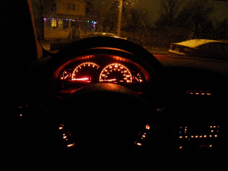

On the topic of lights, 2 things I thought of. Can't find a pic, but I cut the headliner a little and ran an extension wire to use a Gen 2 upeer high brake light - the LED bar at the top of the window. So much cleaner than the trapezoid deck light of Gen 1, IMO. I also did a bunch of work to convert the interior dash lights to orange. That's one BMW copycat item I wish Ford did from the start. Maybe I've jsut spent too much time in pedestrian Ford Tauruses, but the standard green evoques nothing in me. Needles are red, as that's the only color that works on them. I don't feel like going into detail at the moment but it's a whole project using SMD LEDs, through-hole LEDs, and LED bulbs to varying degrees with varying success and varying longevity. Anothe project waiting for me to revamp it when I get a spare 2 months or something.
