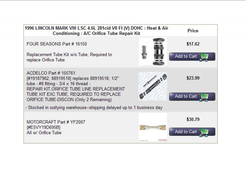

You can't change the orifice tube on a MVKIII. It is inserted and crimped in the line between the condensor and evaporator. You must change the whole line. It is not a $3 part.
That depends, it can be cut out and there is a replacement kit for it to make the orifice tube replaceable... give me a few to find the kit.
I'll post it here.
Bill

Yes, you can install the kit, but it is not cheap. Also, I was simply referring to how the stock system is configured. Replacement lines are cheap, and are overall easier to do.
I didnt think 30.00 and some time was too overly long and expensive.. it takes about 10 min to install once you get to the line and then you have to refill the system... but makes it easier to replace in the future... and 30.00 is the more expensive kit.. there are some cheaper..
BTW,, I'm not trying to get into a Pi$$ing war, I just know there are alternative options for those like me who are limited in funds.. what is the cost of a replacement line with built in orifice tube? I havent looked into that.. ( sorry just checked, its a minimum of 50.00 + shipping, and goes as much as 80.00 for that hose.. I would rather try the least expensive route first..)
Just my .02 Cents.
No pissing intended. I guess it depends upon where you buy from. The line from autozone is $41.99, with no shipping charges. Then again, I also changed the accumulator which is recommended anytime you change the orifice tube or compressor and flushed the evaporator and condensor too.... :)
