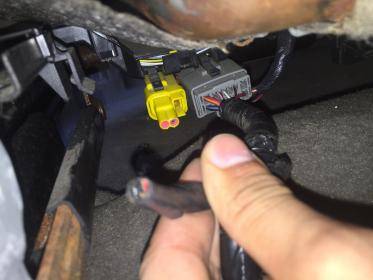

image.jpg so joe i found the yelllo plug cut, i toook the two wires and electrical taped them for now. What do i need to do from here
Are you sure the wires didn't break, as opposed to being cut?
Replace the plug or bypass it and splice the wires (be sure to solder).
I am a bit confused. You said "wiring under drivers seat is good" Now you show that it clearly is not. It's hard to impossible to give good advice when false info is given.
