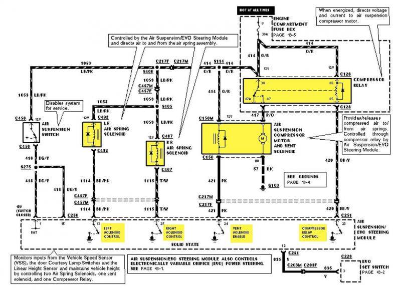

Hey .....im new to this site and I dont really know if anyone posted this question yet.....does anyone know how to tap into the air ride so you can control it manually or as if it was custom.....im pretty good with working on cars and wanted to see if I could do this idea for cheap....I have a 1995 tc signature dark green.....
Sure you could. All you have to do is control the compressor, vent solenoid and spring solenoids (2) in the correct sequences.
But WHY?
Here's the road map. Knock yourself out.

I want to make it for show.....so when I park it and hit a button it will go down slow and lay the frame to the ground....like a lowrider
So how do I make this work.....what do I have to do....how do I control compressor solenoid and the spring solenoid....I understand u gave me the lay out....but do I have run my own air lines or what ?
You have the diagram and you said "im [sic] pretty good with working on cars". I'm not going to explain how to do it. I wouldn't abet anyone doing that to a luxury car. Sorry. The only thing I would add is no new air lines are needed, just wiring.
