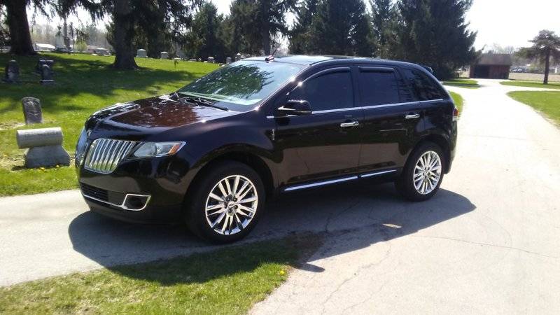

    Hello everyone! I haven't spoke in awhile (just lurk'n). I had a 94 MKVIII for 16 years (1994). I replaced everything that went wrong with the air ride. The ride was always perfect after I was done! I loved that car, I loved the air ride!
    If I ever had to do it again...and I will!
    The air ride will be converted to springs! It's just too unpredictable. One day it's fine and the next it's....well you know.
    It's just my input but, MK8's are very old now and it doesn't matter if it has air or springs, no matter the age or condition! They all go for the same price.
    Springs may even be worth a little more to me because of the dependability. Who care if it's original? What matters is....is it dependable?
    I have spent more then double the amount to keep the air ride going when I could have just converted to springs.
    This is just my opinion, no harm done.
    I'm always lurk'n and watch'n :)
    Just in case anyone is wondering, I got rid of it for this and never looked back...:)
    Still stayed with Lincoln tho 20170412_125456.jpg :)
