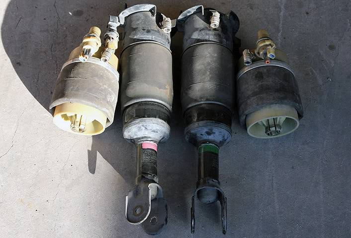

just curious if anyone has seen it done. seems like a lot of work but maybe not impossible?

seems easy enough, just put some fittings on mark viii bags for the front, the back shouldnt be too much work to use aftermarket bags
How about wiring in the air ride computer? Where does the computer pull speed readings from to know when to raise and lower the car?
Then, we have the whole ignition/self test functions. There is more to it than just slapping 4 bags and a compressor under the third to convert it.
^^thats what i was wondering, everything would bolt up pretty easy but i think youd end up running a lot of wire
