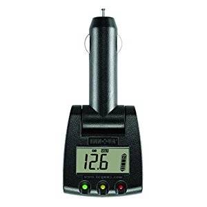

And the voltage warning on the computer wont warn you till the voltage is at 9 volts. Ask me how I know. :p
Did you get the purdy dash light show before the car stranded you? :D
I have one of these.
I was told they are a must if you own a Mark VIII
x2...i learned the hard way any charging issue i may think i have i always grab my multimeter and make sure im charging right at the battery

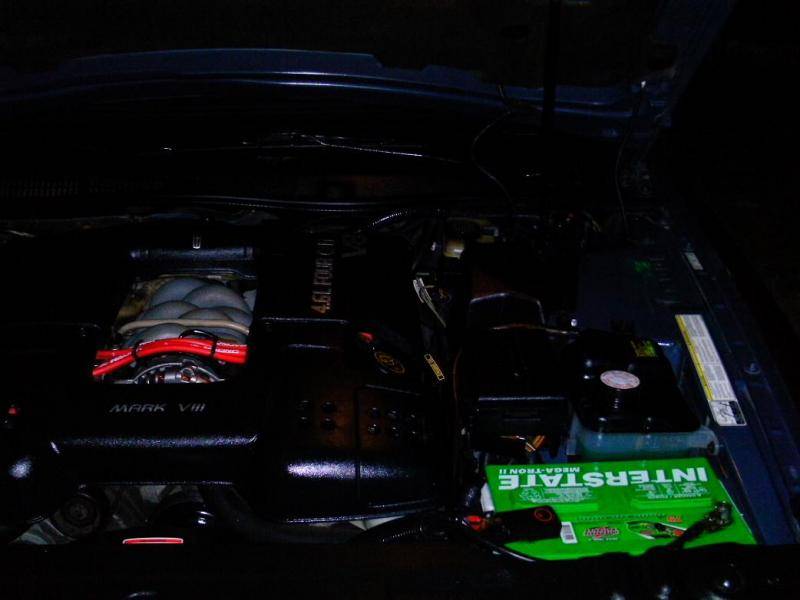

I am gonna bet 40 cookies battery is like a rabbit shot with a 12 gauge. Get an Interstate BIG GREEN BATTERY FTW!!!!!!!!!!!
