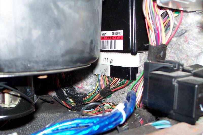

Its located behind the passenger side kick panel. Has a black and a gray connector going into it. Find a member close by and try their module in yours, just incase the module isn't the problem.
I think they are interchangeable from year to year, but couldn't say for certain.

Here is a picture for reference, it's the black box in the middle of the picture. It has the gray and black connector. White label with red stripe, part no. F7LF-3B494-AA. Hopefully you don't have to pull the dash out to get to it, but I really can't say for sure.
I can even do you one better. Here are the removal instructions, follow the link, verify the image, download the file. http://www.yourfilehost.com/media.php?cat=other&file=SCM.pdf
