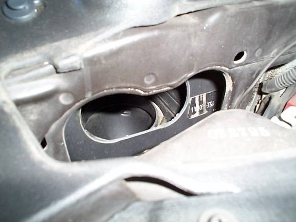

I cut a oval hole in mine as I did not want to drill a bunch of holes:eek: I had a cone on the car when I first bought it, I tossed that thing in the trash. All it did was suck up hot air from the engine compartment.
