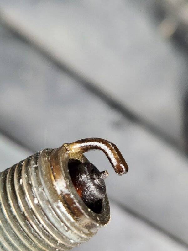

So it got worse last night.. oil spraying all over.. puddle under the filter..
Flashing CEL came on and a "distinct" bad misfire.. usually can still drive on 1 bad coil but had a major powerloss. No fail safe mode.
Got off the road and the car died in park. Swapped coils first no change. Blue smoke blowing out this time and a bad clanking noise. Pull cyclinder #6 plug and its covered in fresh oil. Guess the motor went..
Debating to part out, get another engine if its worth it at this point in time or if this one is even repairable? Beyond my knowledge..
Debating to part out, get another engine if its worth it at this point in time or if this one is even repairable? Beyond my knowledge..View attachment 828577593

In your case a chain tensioner may have failed. That could mean a piston hit a valve. That would/could explain the oil on the plug, and the bad misfire.
Pull the front cover and the head on the one side.
